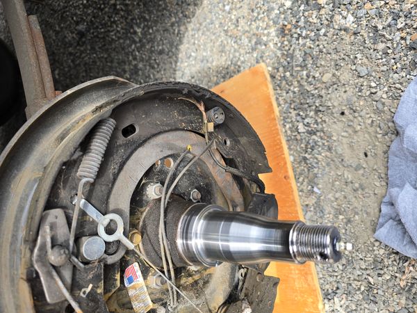

so, I had the famous "trailer disconnected "  on my f350 and decided to take a look and see if I could find what was causing it.  so I took a resistance reading at the pig tale and got 1.2 Ohm, so that tells me one brake is not working so under the 5th I go.  on the last brake this is what I see (all the others were drawing 2.9 amps with the emergency breakaway pulled.)

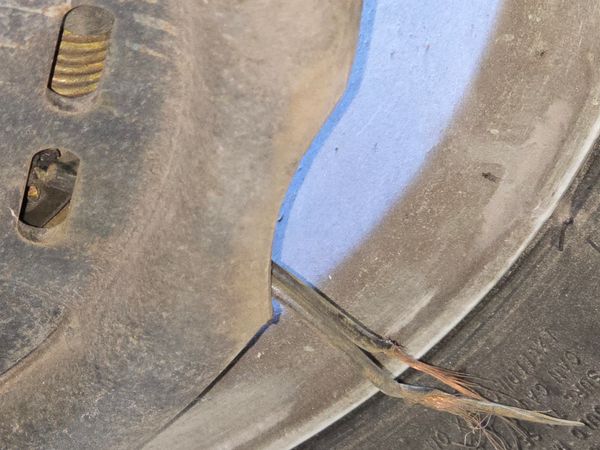

so when I opened up the brake this is what I found, the good thing is just the wires broke, but a whole new brake assembly including the backing plate is only 50 bucks (CDN) so I decided just to replace everything.

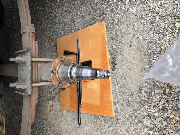

unfortunately the new brake assemblies took about 7 days to get here so this is how it sat for a week (wrapped up to keep the dust and rain off it though.

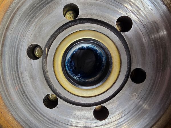

figured while I was at it I would put a new grease seal in and check the Berrings, as I have just been using the ezlube for the last 9 years on this rv.  bearings are in perfect shape.
