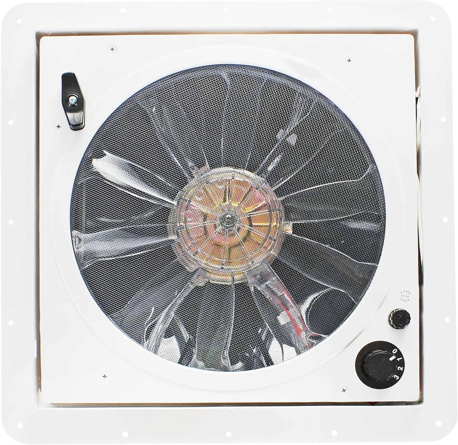

In essence I am down grading my unit not upgrading it. But I am still retaining Pulse Width Control of the motor since my motor is the model that is designed for PWM trimming while remaining silent.
It's a little odd what I am doing but it's not pricey at all to do, many wouldn't understand unless they had the model fan that I do and they lost the remote lol. When my parts get here and I've figured out where to source the individual items I will make a proper DIY post and ask the moderators to delete this thread, being that a lot of it is rant on Dometic :D
When all is said and done in the end I envision it looking just as the picture I posted but with my PWM speed control switch in place. That way I have a clean install and no switches or holes exposed from items I am removing like the lift motor mounting and the rain sensor switch.
I may try to locate a model 1200 face plate and remove that buss fuse since they're known to be problematic and instead use that location for the reversible toggle switch that is supplied with the PWM control, then I can just use a standard automotive blade fuse somewhere hidden inside the unit or behind the trim molding.
Model 1200 face plate.
