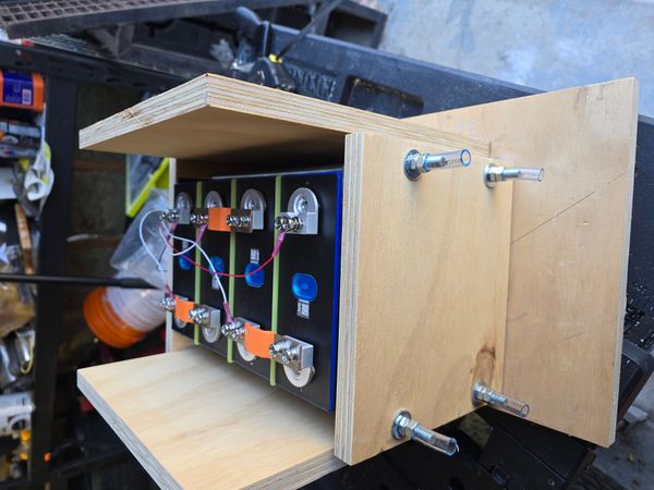

So with that in mind I decide to make something up on the go and see how it turns out, keeping in mind it has to be able to provide compression to the cells, act as a support for the first shelf, and provide mounting places for all the electrical bits.

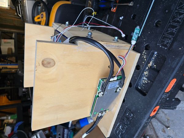

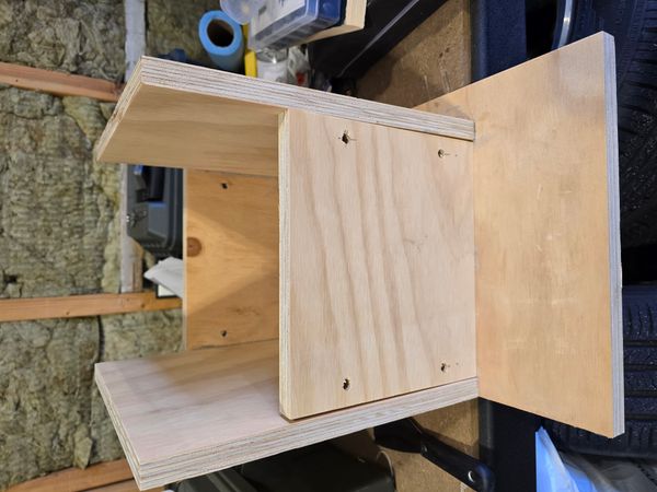

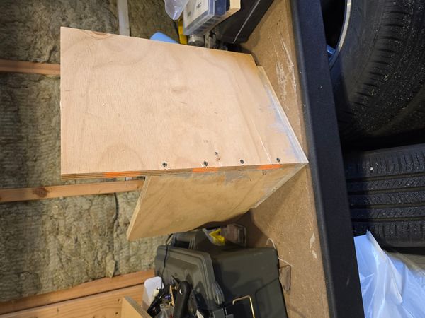

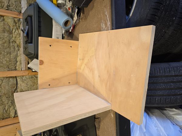

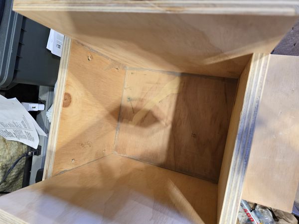

bottom, back, and one side on. glued and screwed togeatherused construction adhesive and screws.other hard side installed, the front panel is floating and will be used to provide the compression.rubber mating on the bottom of the battery and both endsclear vinal tubing over the threaded rod so it can't scratch the cellsrods installed and slight compression applied. I may switch out to longer rods and use springs on it once I figure out which springs to use. the chunks of vinal tubing are just to protect my hands while I am working on it.. I have a bad habit of cutting my self on anything that I can hahajudging approximate location of BMS, and hole drilled to tape the temp sensors to the side of the battery cells

Looks good great job so far. I doubt I would paint the boxes as they are inside an interior cabinet. Do you mind expanding on the compression of the cells? Is the compression just to keep them from moving around in the box? Or is there a engineering advantage to putting pressure on the cell cases?
