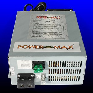

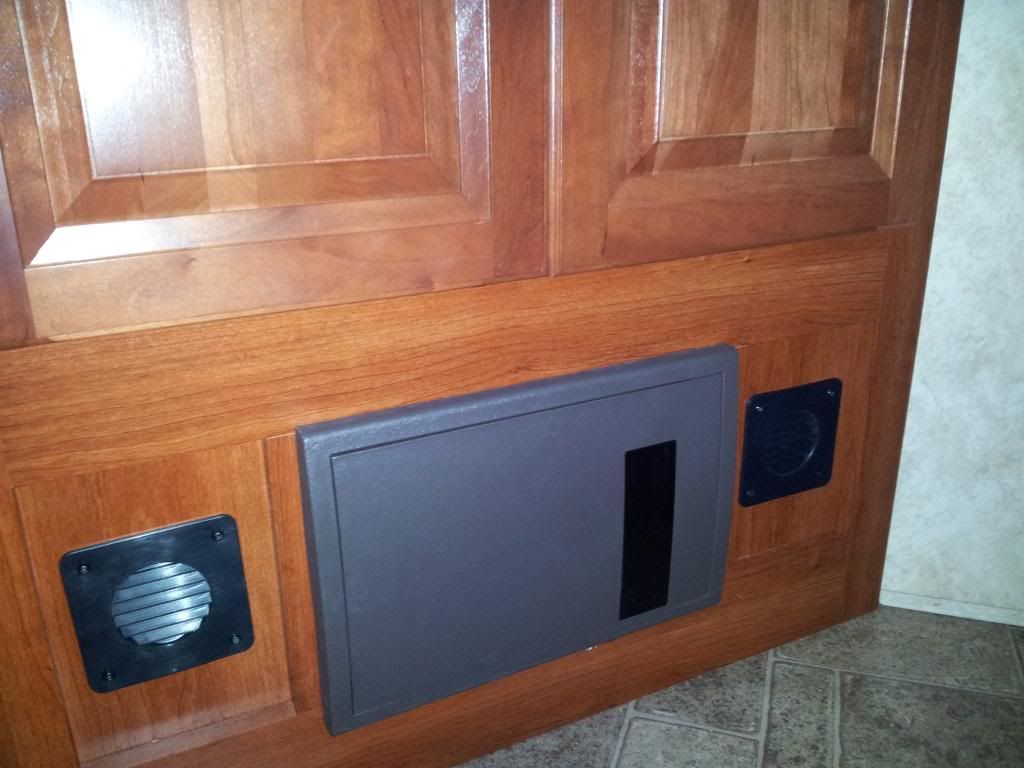

3-4 years life out of a junk WFCO converter is probably average, but I think it could have been extended somewhat if the engineers at Keystone (Cougar) would have thought that a piece of equipment that itself is fan cooled ought not to be mounted in a small, sealed cabinet.
After replacing the converter with a new one (POWER MAX PM3-55A), I took the time to hole saw some ventilation holes in the cabinet and cover the holes with the same small louvered covers that they use to vent battery boxes. It turned out ok.
