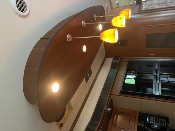

    • joebedford's avatar
      joebedford
      Nomad III
      Can you imagine the amount of work to get at the a/c behind this thing?
      • valhalla360's avatar
        valhalla360
        Navigator
        Probably easier to go in thru the top and open it up rather than go in thru the bottom. It will take a little more disassembly vs your typical air/con install where there is a panel in the ceiling.
