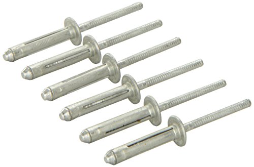

I like Oscar rivets, a type of blind rivet with a split shaft that widens out behind 1/8" luan plywood when installed. They're made for use in RVs and are available from online RV parts vendors and Amazon. Not exactly cheap but they are very strong and great for things that are heavy or need to be well secured in place.
