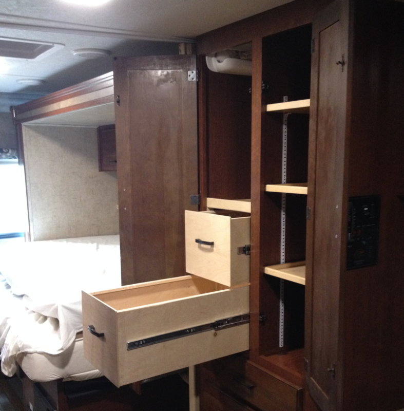

- drgslayrExplorerEMD360, Do you have a link to that shelf? That looks perfect for what I have been looking for.
Ron - EMD360ExplorerI recently installed this in the “shirt cupboard” next to our refrigerator. $70 from Amazon.
- BruceMcExplorer IIII improved our pantry and wardrobe as follows:
The wardrobe had just a hanger rack, no drawers, and the pantry had these plastic standards that had spring loaded support brackets every couple of inches; each with very sharp points. Every time we'd reach in, we'd get scratched by thoses dang things. Also, the shelves were cut too narrow, and would fall occasionally. Rather than try to get the dealer to "fix" them, I replaced them.

Just follow the instructions in This Link It is pretty easy to do. - La_GasserExplorerI added a 2 drawer unit from Lowes which slides out. You can see several sizes on the Lowes website - just search for "soft close cabinet inserts". I'd insert a picture of the mine but I don't know how to attach photos.
- Dick_BExplorerUnless you are a full timer, with no access to woodworking tools, it shouldn't be too hard to build one to your exact dimensions. I think I would use 1/2 inch plywood for the sides and back (front door?) piano hinge. use 1 x 2 horizontal supports on the sides to hold up the 1/2 inch shelves. You can use screen bead across the front of the shelves to dress them up. It's not Amish furniture but it would probably get the job done.
