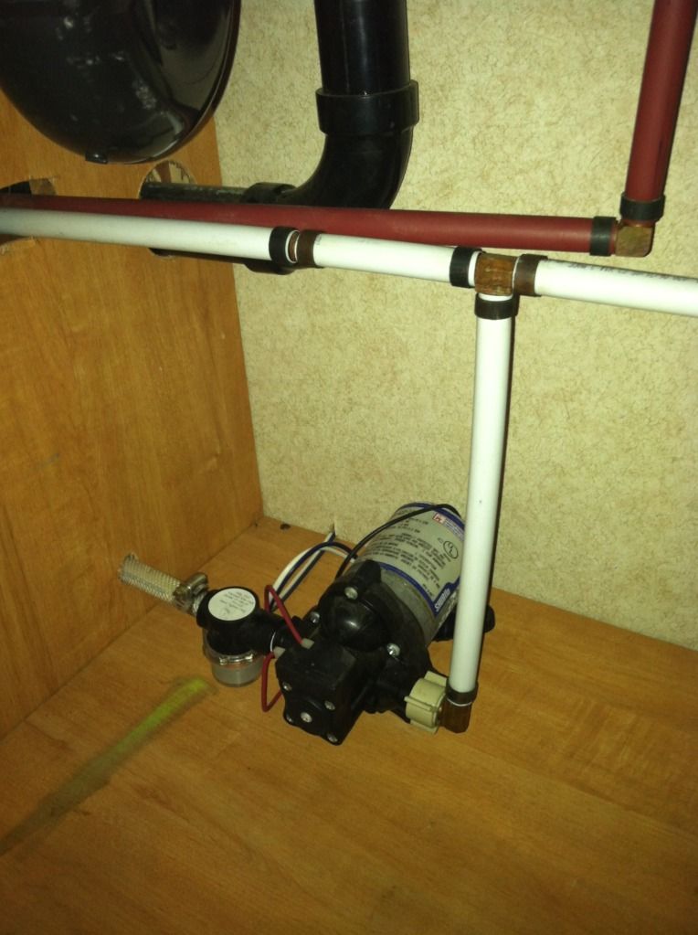

I am looking to move my FW pump and do some silencing.
It currently resides under the kitchen sink and takes up valuable space for storing pots/pans.
There is a small storage next to it that is where the FW fill comes through.
I am thinking of mounting the pump vertical against the wall that divides the under sink storage from the smaller area.
My questions:
#1 Can I mount the pump vertical?
#2 Will that be difficult to silence?
#3 Is that pex tubing, and can you use worm clamps on it?
Thank you

  • I did a few things to quiet down the pump on my previous TT...see picture here.
    1. Mounted the pump to the floor on a sandwich of 1/2" plywood with 3" of high-density foam between.
    2. Replaced the rigid PEX with flexible reinforced vinyl hoses.
    3. Added padding anywhere the hoses could contact a hard surface.
    4. Added a 5-gal accumulator tank to the FW system.
    All together seemed to help a lot!
