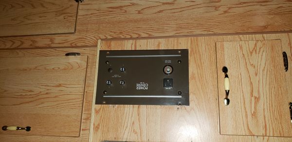

the first recorded DIY I have was the power center on the 1991 Slumber Queen.
this is what came with it, a single stage battery killer

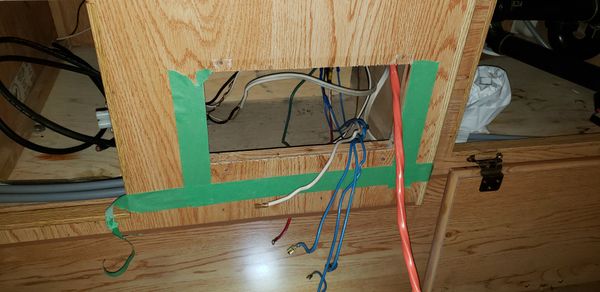

there wasn't any replacement sections to this one and I wanted to get rid of the glass fuses and the AC reset breaker, so I ended up going with a PD 4000 series.
I had to enlarge the hole a bit

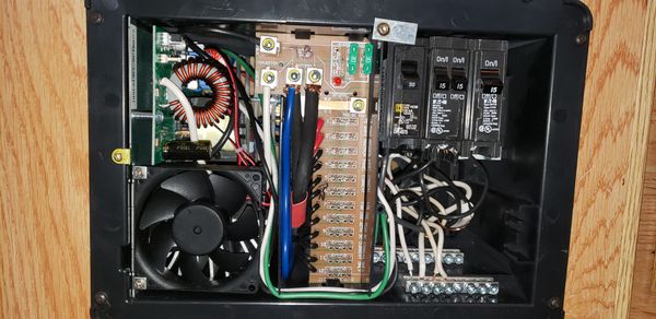

I split up the DC into a couple more circuits and added an AC breaker for future use

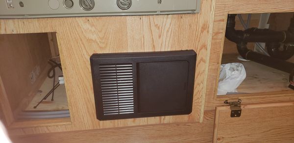

and the final result
