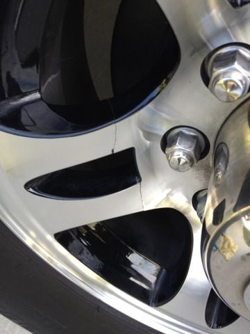

The eight-bolt tire at that link is an 80 psi, as is the identical looking Sendel at this link.
Both are visual matches to the O.P.'s. wheel. Sendel does offer a 110psi eight lug version of that wheel, but unless the OEM tires were higher than 80psi, does anyone think that the trailermaker would have supplied 110psi wheels with this trailer?
Seems to me that the best bet for the right answer as to what's already on is to inquire of the trailermaker as advised earlier. It seems to me sorta moot in the case of this particular wheel since it's already shot, and presumably it'll be replaced with the higher psi wheel called for by the G614's on the trailer.
But it would certainly be good to know as far as the other three are concerned in case there are any concerns about the potential for them to go too... - Me_AgainExplorer IIITredit is well aware of this and will provide replacements that are rated higher. Chris

Me Again wrote:
The T03 are noted to crack on the spokes near the hub. Chris
And another one!
OUCH! It looks like it may be time to upgrade the wheels...which suck$. - Golden_HVACExplorer
And another one!
That is the disadvantage of cast aluminum parts. They can crack, while forged aluminum are cut out of one block of aluminum, and much less likely to fail.

- big_bufordExplorerIt appears the plot thickens :S
The tr8 is a diffrent wheel than you have.
Hi spec wheel also makes a series S5 wheel that looks exactly like the sendel to3.
The hi spec is rated at 39xx lbs at 110 psi.
How to tell which one you have? I think the best option is to call manuf of trailer like somebody else pointed out.

- Winged_OneExplorerCan anyone decipher this:
Sendal says "3580 LBS @ 100 PSI & CERTIFIED SAE J1204 SPECS"
http://www.sendelwheel.com/wheels/t03sm
A different wheel at trailer wheels.com says: "3,960 lb Capacity @ 110 PSI & CERTIFIED SAE J1204 SPECS"
http://www.trailer-wheels.com/16x65-Aluminum-TR8-Trailer-Wheel-8-Lug-3960-lb-Max-Load_p_1240.html
Thus, is my wheel rated for 100 psi? - Winged_OneExplorerThanks for the help!
