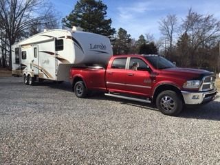

Curious why you wouldn't lower the 5th by adjusting the pin box? Picture appears you have a ton of room between 5th and truck rails.
Because it is sitting level and has never been a problem in the 5,000 miles we have pulled it in the last year. It's like I said before, anyone with these high profile trailers need to watch what they go under. Several of the campgrounds we have been to seem to care less about low branches and that does not mix well with a rubber roof. We have also seen some service station canopies with 13 foot clearance.
It's your dice and your dime, but if my rig were taller than 13'6" which is the federal standard. I would make some adjustments.
Frankly 5K miles is not a lot of miles in the grand scheme of things.
The risk is just not worth it. Hitting an overpass would be disastrous. - janegowestExplorerTravelnutz, your intelligence makes my head swim!! : )

It is about finding balance. 7 - avvidclif1ExplorerFWIW your picture doesn't make it look level...
Because it is sitting level and has never been a problem in the 5,000 miles we have pulled it in the last year. It's like I said before, anyone with these high profile trailers need to watch what they go under. Several of the campgrounds we have been to seem to care less about low branches and that does not mix well with a rubber roof. We have also seen some service station canopies with 13 foot clearance. - SabreCanuckExplorer

Curious why you wouldn't lower the 5th by adjusting the pin box? Picture appears you have a ton of room between 5th and truck rails. - ArcamperExplorer

Arcamper wrote:
I have done both. From our 2007 Laredo at 11' 6" tall and 32 feet long.
To our new Montana at 13' 7" tall and 38 feet long.
The statement above about having enough truck has been very true in my case because I have a lot of stability in any condition. The big difference I see going from one to the other is you really have to watch for low tree limbs and every thing else that you go under. You just get used to it.
By the way the height difference in the bedroom of the Montana is much better and we would never go back to anything smaller.Moderator edit to re-size pictures to forum recommended limit of 640px maximum width
