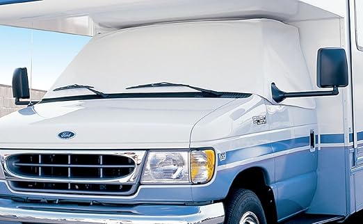

- rdrv831ExplorerWe did a cross country trip this summer and the AC kept up just fine. From South Carolina humidity to Arizona heat. We close off the cab area with a thick curtain and cover the cab window with
One thing we did before the trip was have all the coach windows tinted with 95% UV blocking film. This helped out a lot with temp and with privacy.
Cab cover from Amazon (not my RV, the picture is from Amazon)
