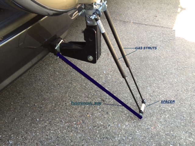

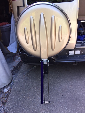

Excellent solution.
I had seen your design while researching the issue and decided that i did not want to get that involved in solving the problem.
I was not that agressive in trying to solve my problem.
My objective was simplicity and minimum effort since I wanted something that I could assemble quickly before going on my first trip with the RV.
I think I may finally settle on a 2 linear actuator design for this coming season.

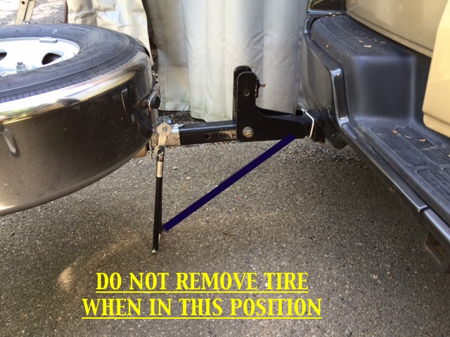

I added words of caution on my photo.

Stanley - QUAD-EExplorerBooster,
Thanks again for the info.
My original objective was to come up with an arrangement that required minimum effort to attach and use.
The Attach-A-Lift does that. No drilling required. Just attach the U-bolts and nuts.
I leave the u-bolts permanently attached. The total cost for everything is less than $50.
The strut assembly can be attached or removed in probably less than 1 minute but I usually take about 2-3minutes.
I used 2 struts so in case one failed there would still be some resistance.
I thought the Ezee-lift was too expensive and required too much assembling.
I also agree with your comment relative to metal springs.
With the linear actuators design I get the DC power from the hitch wires.

There have been a few tweaks since that thread, like improved speed control and solid aluminum pullies. - boosterExplorerI think a safety catch is incorporated in all the factory lifters, and is often hard to use, it appears. Ezee-lift's spring loaded unit has non-captive one that probably wouldn't pass OEM legal rules, as it is non self activating and could be lost.
I went through the entire routine myself 6+ years ago, and passed on anything that was spring loaded with either metal springs or air springs, because of the issue

I think there are pix of our setup on this forum someplace, I will try to find them. - QUAD-EExplorerBooster,
You are correct.
I had considered this but have not incorporated it.
Your comment prompts me to note this caution in the presentation and/or add a safety attachment.
I do have an alternate design with a linear actuator which would eliminate this concern.
If you are interested in seeing this it can be found on Youtube and Google by typing in
Attach-A-Lift
Thanks for your feedback.
QUAD-E - boosterExplorerSafety catch in case someone removes the tire with the preload on the stuts?
