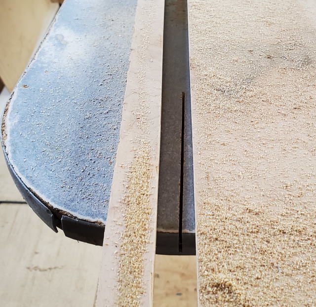

Anyhow, todays work doesn't look like a whole lot, but it takes a while to get the curved roof line cut correctly. Would I do a curved roof again? Yup. Even though it's a pain to do any partitions, I still like it.
This is the beginning of the partition for the refer and some shelving.
I used a piece of 3/4" plywood, as I wanted something sturdy in there for shelving, and this piece was nice and straight.
It's ready to drill my pocket holes in. Should happen tomorrow.
