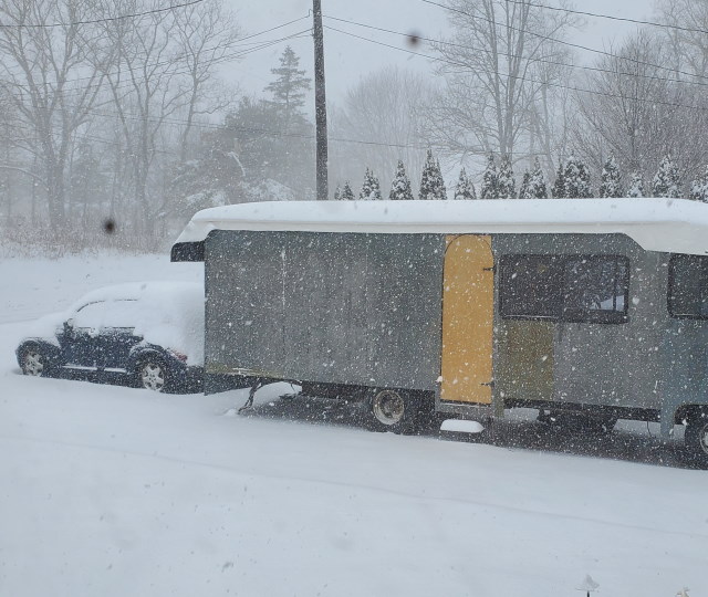

- Bruce_BrownModerator10" of snow is big???
That's a dusting around here. :B
As our son says, "go big or go home". Lol.
Looks like we're heading for at least 10 or more inches of snow until this is over in the morning.PastorCharlie wrote:
