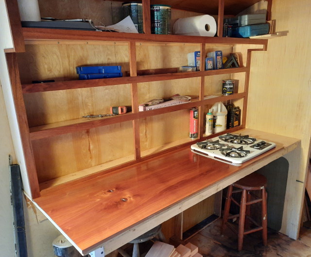

- I put the stove back in the counter to see how it would look. I think I like it! No, it's not fastened.

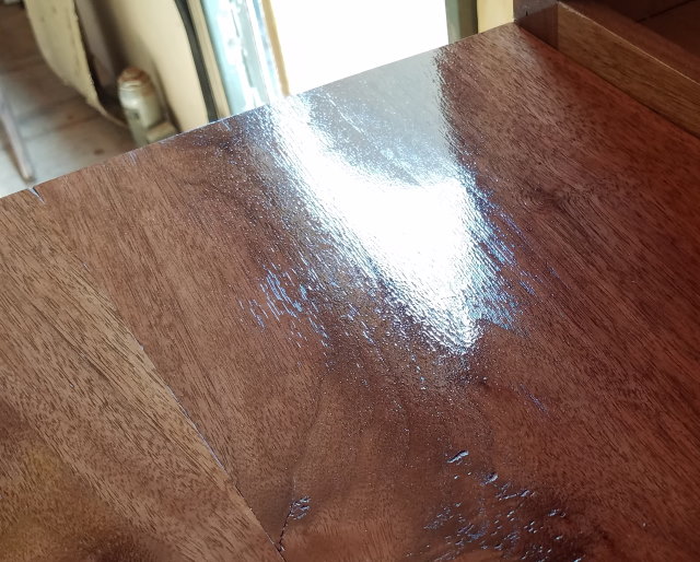

Looked like the POR15 raised the grain on the walnut. Are you fine sanding between coats to get a glass like surface? Or are you just applying more POR15 to the previous layer? Brings out the color and grain quite nicely. Looks good.
It actually did not raise the grain. It kind of looks like that, but I think it is primarily due to camera and light glare.
Yesterday, I applied the first coat early in the morning, and by the time I got back for the second coat, it was fully dry, which meant that I had to give it a light sanding.
After applying the second coat, when I went to apply the third coat, it was - as Por 15 says - "dry to the touch, but with slight finger drag". That meant that I did not have to sand the second coat before applying the 3rd.
I am applying these coats with the little white foam rollers, that are meant for cabinets and doors, and they produce a nice fine surface, if applied carefully, and with very light pressure on the last rollover.- STBRetiredExplorerWell, you always sand between coats on any automotive finish, and POR15 is an automotive finish. Don't remember, but does the clear contain UV protectant?

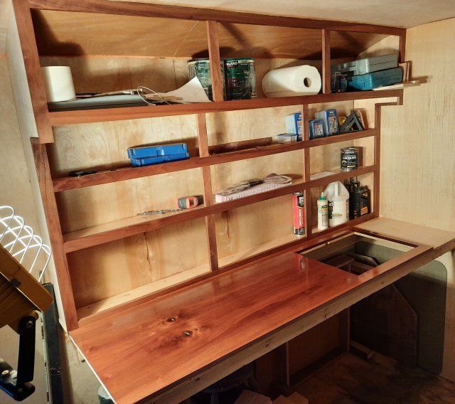

- And there we go. After adding 3 nice coats today, it's beginning to look better!
And another shot from a different direction. I'm thinking, that I am liking what I see! YeeHaw!!!!

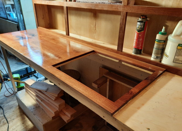

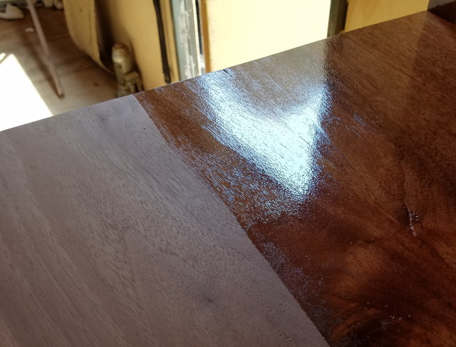

- The beginning of adding Por 15 Clear on the passenger side counter top.
Nothing like a real high gloss shine. This was still wet when I took the picture.

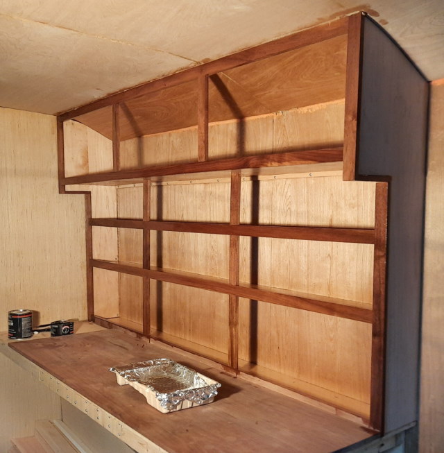

I got up early this morning, and managed to get a coat of Lacquer on before breakfast, and then this evening I added the third coat, so I think they are about done.
Next will be to put some finish on the counter tops.
That would look pretty good with some doors on it. :W
Not saying that is completely out of the question. We talked it over, and she wants it open for now. If it turns out that she doesn't like it, we can always add them later.
