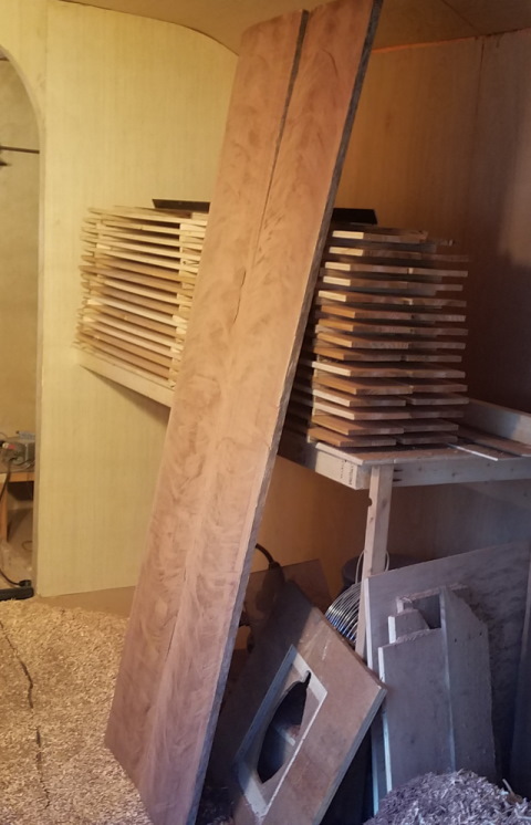

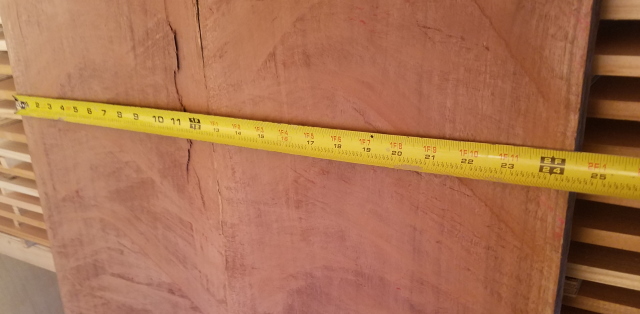

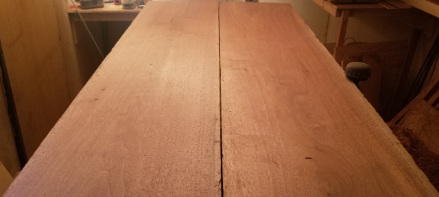

YeeHaw! Only one more plank to split! Well, for now that is. - There we go. With both pieces side by side, we've got just a touch over 24" wide, and identically mirrored.

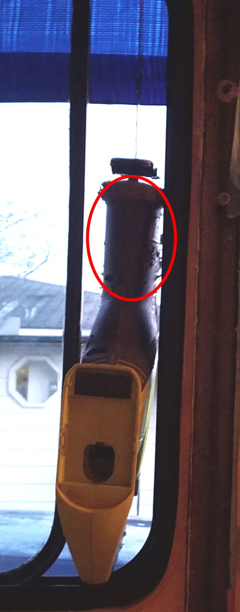

- What ya gonna do, what ya gonna do, what ya gonna do, when yer saw overheats?
Redneck answer, 101.. Lol.
Insert fan in back window, open co pilots window, insert said overheated tool, and turn on fan. Also keeps the rig cool!
The area inside the red circle was getting warmer than I would have liked, so I figured, it's time to cool it off a little bit.

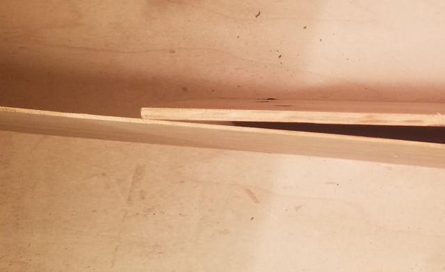

I took a thicker piece of wood and laid the thin piece of oak on top of it, and started running that through the planer.
The thicker piece went about 1/2 way through, and then stopped, but the thin piece, slid right on through, on top of the thicker piece. I was able to reduce the thickness of the piece of oak down to about 1/16 of an inch.

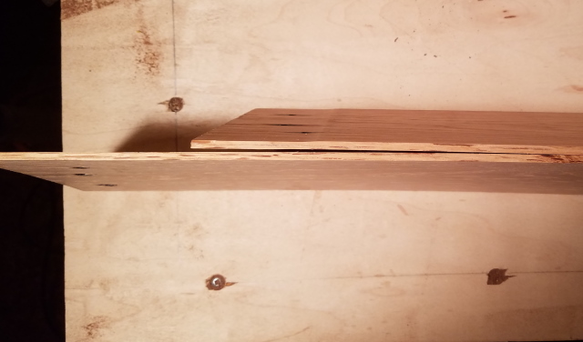

Below is a pic of the 2 pieces from last night. I only planed the one, and you can see how much thinner it is compared to the other one.
I do think the piece of melamine laying on the bed would work better, but I didn't have any, and I just wanted to try this out. I am satisfied that thinner stock can be planed with this planer. Wahoo!!

- Here is a view from the side, of both of these pieces, so you can see, they are not very thick. Like I said, they are just a touch over 1/8" thick
Overall, I am pleased with the way they came out. The planer did a nice job on such thin stock. Wahoo!!
