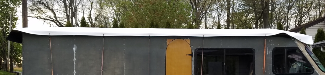

- And there we go! It's up there! Wahoo!

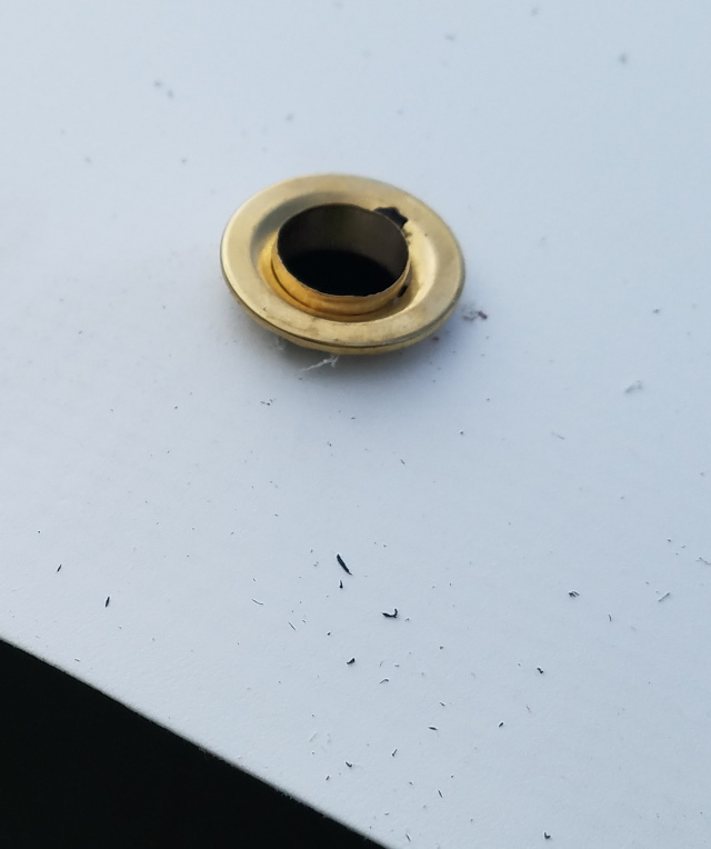

- Fits just like a glove! After finishing the installation of the grommet, it's just not going anywhere.
The fiberglass in the TPO will not allow that grommet to go anywhere.
It's a lot easier to pull them out of a tarp, as I never was able to pull one of these out of the TPO.

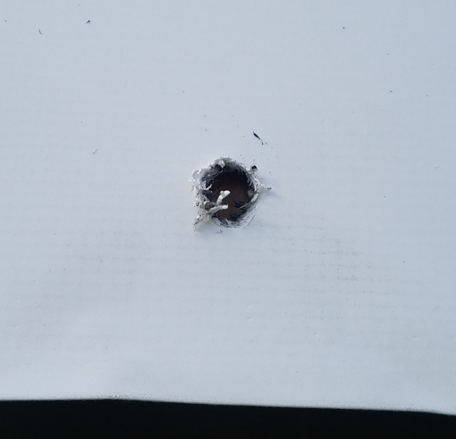

- In order to keep the TPO from blowing away during the next few days of rain that is supposed to be coming, I needed a way to hold it in place after putting it on the roof.
I wanted to add some grommets along the sides to hook my straps to. Wouldn't you know it? The best way I found to cut the hole for the grommet, was to "drill it"! That TPO/rubber in .060, is tough stuff.
After drilling, the hole is just a touch jagged, but still able to get the grommet in place.

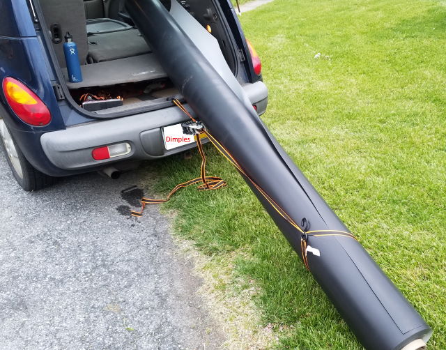

- The PT rides again! This is what I did, when I needed to move the left over piece of rubber, and needed some assistance getting it back inside the car.
Yea, hooked up a ratchet strap, and applied some pressure, and gave it a little extra help with my hands. Little slow, but after a few of these, I was able to get it inside.
By the way, I did make sure the place I hooked would stand the pressure. It's the hook to hold the rear hatch closed, and it's pretty sturdy.
It was during this time, that I broke my nail, (like anyone cares, Lol).

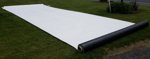

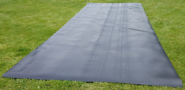

- Here's what part of my day looked like. I rolled out some TPO to get ready to cut off a piece 25' long.
Flipped it over, after cutting, to make sure I didn't get a huge bunch of grass on the back side.
