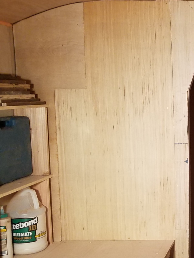

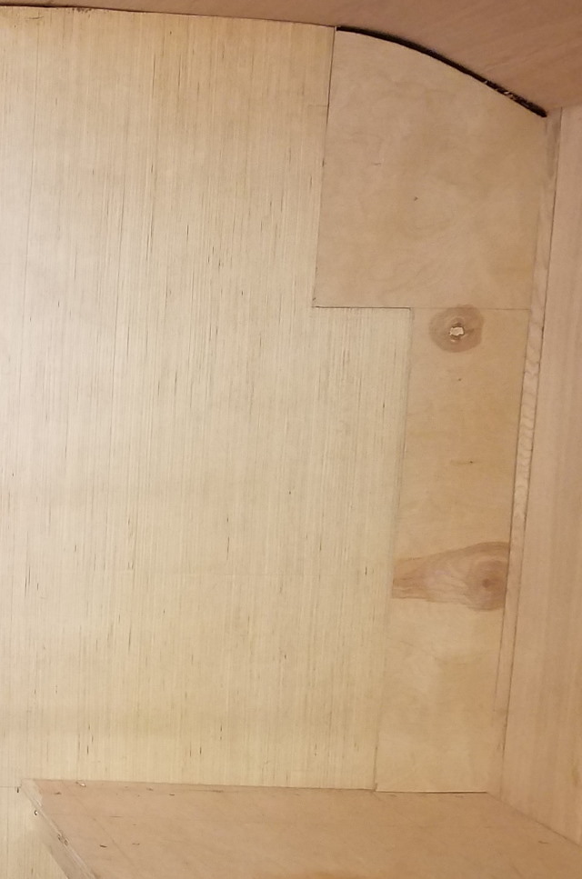

- Here's the start of a pattern for the shelf ends on the passenger side, and the cabinet that will be at the top, and connected to the ceiling.
Currently, the cabinet front would be 15" high, and 12" front to back, with the back wall of the cabinet, being about 11" high, as the ceiling droops about 4 inches.

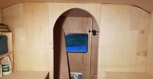

Here's the drivers side at the bath wall.

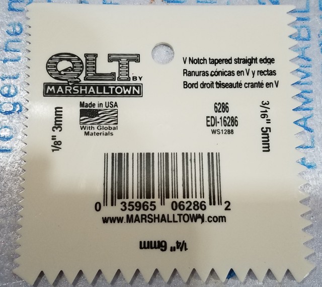

I used one of these to spread the ChemLink. Worked pretty well for larger areas like covering the insulation or plywood.
