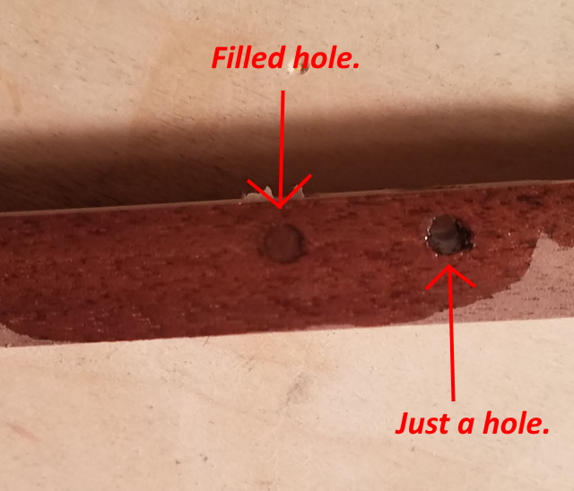

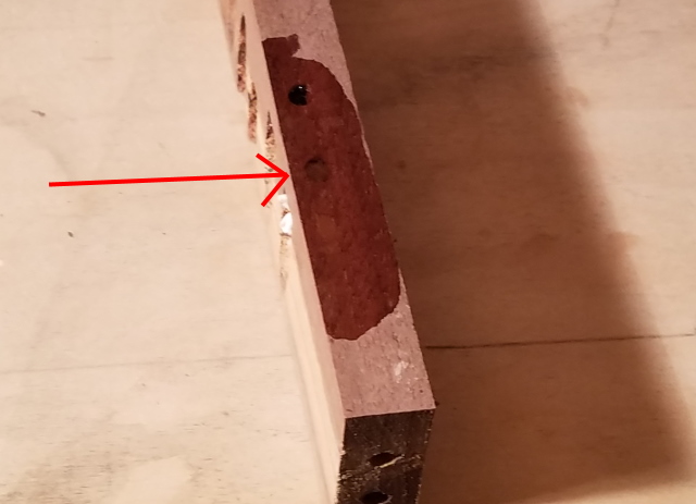

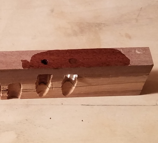

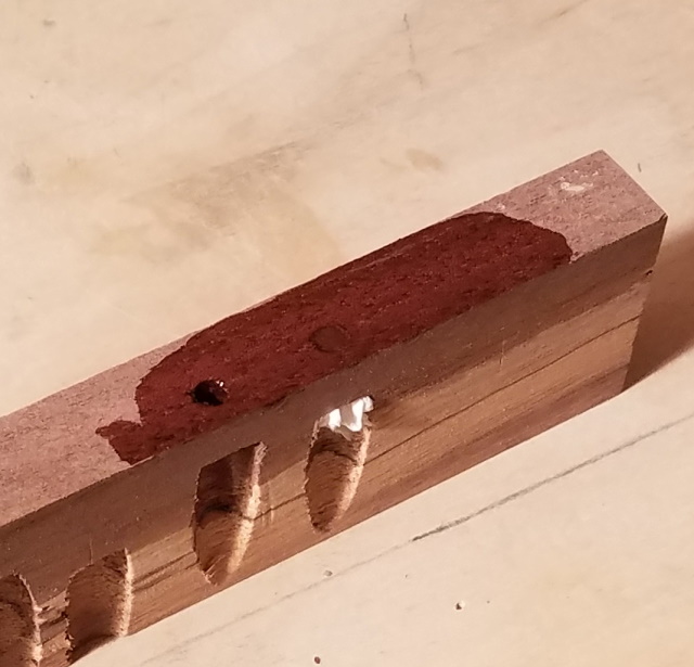

- Then, depending on how you look at it, it blends in pretty good. Not perfect, but this only has one coat of Lacquer on the wood, so we'll see how it looks after it dries and more coats are added.
Either way, it does provide a way to use some sawdust to fill nail holes and imperfections, just by using sanding dust and whatever you are using for a top finish.
- Then, I just filled the hole that I wanted to. I also added some Lacquer to the wood, and left them to dry.

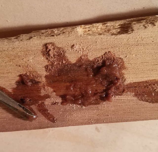

- Next we make a slurry of sanding dust and ... in my case, since I am using Lacquer for a finish on the shelve fronts, I mixed Lacquer and the black walnut dust.
