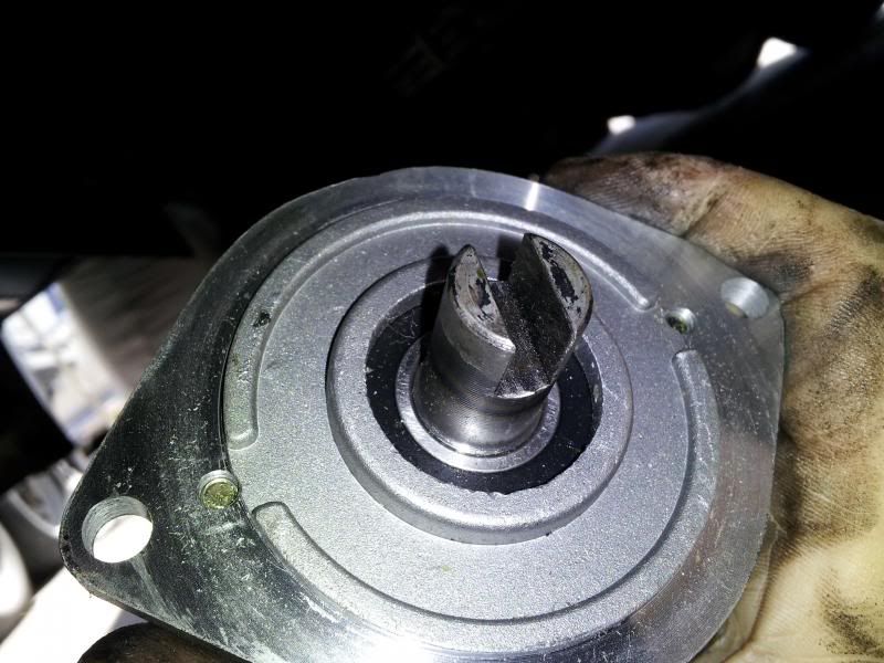

Good morning,
I have a 1997 Thor Residency MH I bought about a month ago and the hydraulic jacks and slide (2) do not work. The electric motor has been replaced and seems to work/spin over fine. The tank is full of fresh/clean fluid and there are no leaks on any of the hoses/jacks/connecters etc. I just recently replaced the shuttle valve (based on my discussions with HWH) but that did not fix the problem. When I push the lift button for the jacks the motor spins (very fast), but nothing happens. If I push the retract buttons for the jacks it just clicks (probably because the jacks are already retracted). The hydraulic slide switched click if pushed in or out, but nothing happens. I even increased the pump pressure, per HWHs recommendation, but adjusting a screw on the side of the assembly, but that didn't help.
HWH said I need to replace the hydraulic pumps/tank assembly. Before I spend about $800.00, I wanted to ask if anyone else has any ideas or experience? Can this part be rebuilt by anyone or does anyone besides HWH sell this part. The information on the pump/tank/motor assembly is:
Pump/Motor/Tank: AP0588
S.N.: 10641
Assembly: AP10514
Thanks again.
