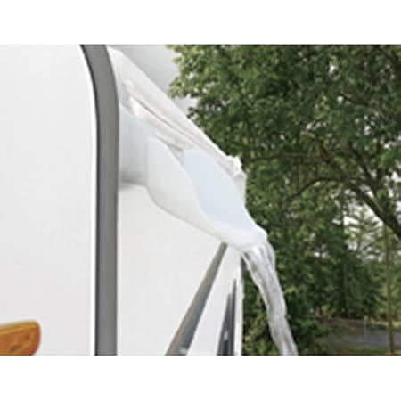

I wanted long gutter spouts because in a heavy rain it will perform like in the below picture (from amazon). In a lighter rain the water will actually wrap under the spout and travel up the underside of the spout for a quarter of an inch or so, before dropping to the ground. I wanted gutter spouts that were long enough to allow this to happen without the water touching the side of the cabover.
Yes, it's not a look that I prefer... but IMO this is a case of function over form.
