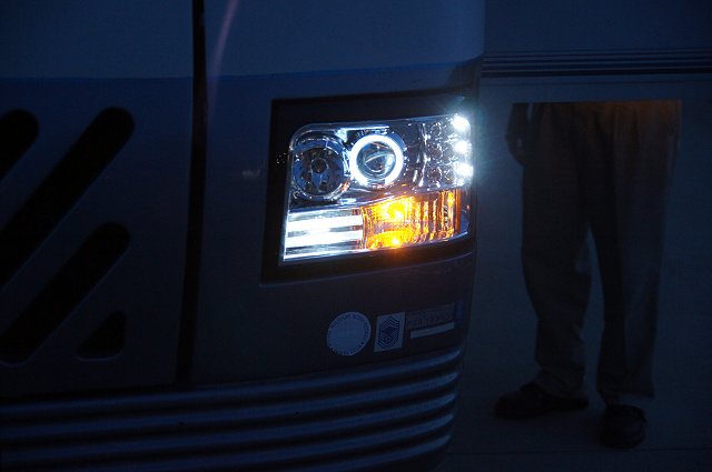

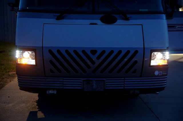

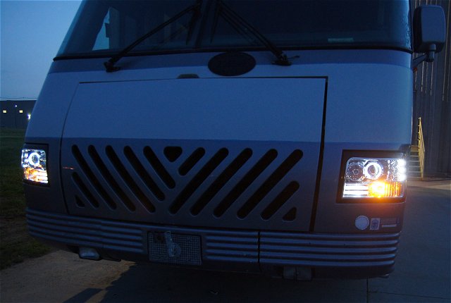

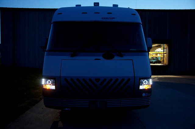

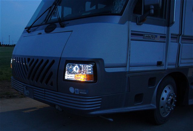

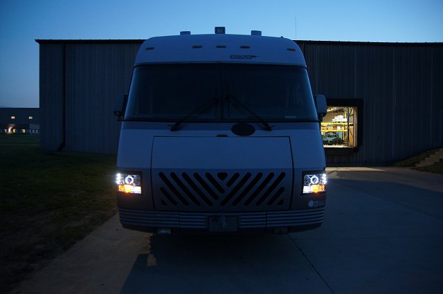

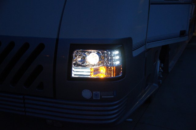

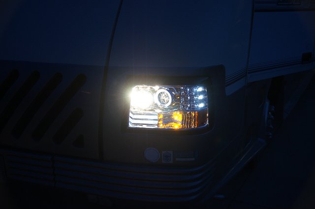

They look nice and they are awesome at night. I'll post some night pictures after I take them. I haven't driven it yet to really see the difference, but they seem brighter by a long shot. Next up is to replace all the marker lights with LED ones and get new fog lights installed.
