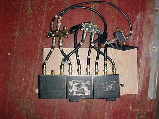

Mine that I used in the 5th wheel kinda looked like this.
http://www.ebay.com/itm/36DB-CABLE-TV-ANTENNA-INLINE-BOOSTER-COAX-SIGNAL-AMPLIFIER-COAXIAL-VIDEO-AMP-HD-/282073601786
Gentlemen, I really want to thank you all for the help. If I were 30 years younger I would maybe remember some of this stuff.
Here is something similar to what I will use in the "C".
