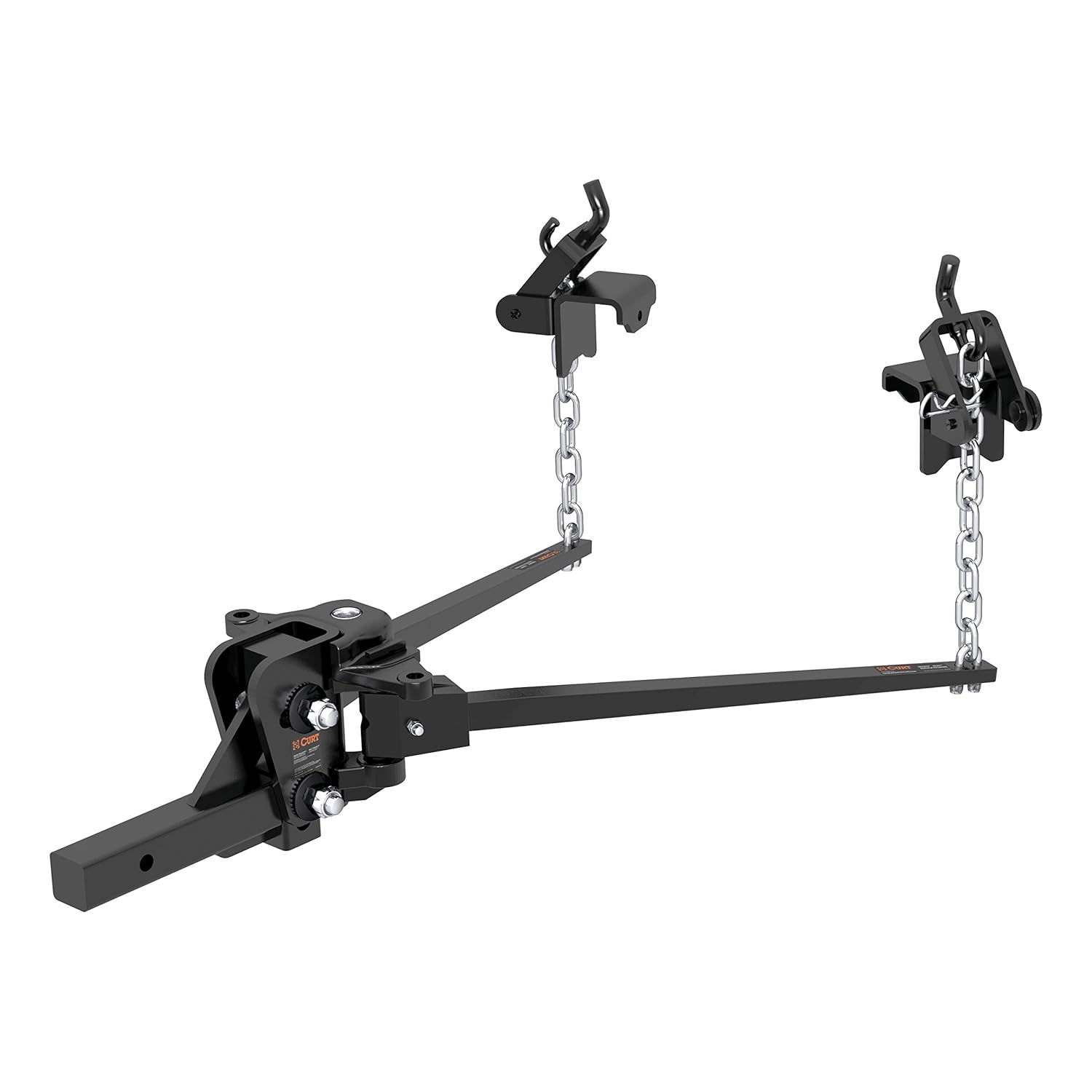

Would something like this for $45 be perfectly fine for a 15' (19' bumper to tongue) trailer, pulled by a 1/2 ton truck:
Curt Manufacturing 17200 Sway Control Kit
http://www.amazon.com/gp/product/B000HLO7QA/ref=ox_sc_sfl_title_1?ie=UTF8&psc=1&smid=ATVPDKIKX0DER
Are the $250+ with the spring rods worth getting?
Should EVERYONE have sway control? Why isn't it standard?

  • That is a sway control kit, as you said.....
    The thing with the spring bars is a weight distributing hitch. It reduces the tongue weight on your hitch, helps your trailer ride more level
    By rights, you should nave both
