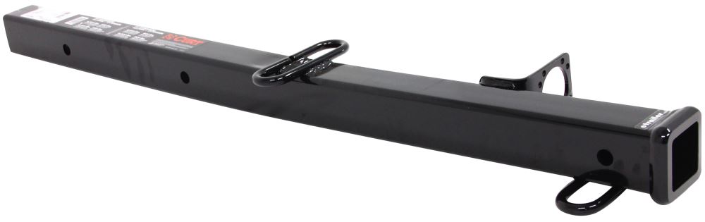

    So many variables.... I launch my 18’ Seaway Sportsman using my front mounted hitch. So far ,by far,the best solution to launch and retrieval.
    What he said. Front hitch is the way to go. No chance of dunking anything, drive wheels nowhere near the water.
  • So many variables. If your 24’ boat is a sailboat with a keel, forget about it. You will drown the truck. If it is a shallow draft power boat on a roller trailer, you don’t need to go deep to launch but you may have to for retrieving. A bunk trailer requires depth for both procedures. You definitely don’t want too long an extension on the vehicle because it will stick out straight when the boat is on the ramp,causing the trailer to be at an extreme angle. Could cause lots of damage. You could get an extension for the trailer ( 6’) and submerge the trailer while the truck stays high and dry. I had a B Touring Cruiser and launched a Whaler Montauk,but I never enjoyed it. I now have a F250 ,4wd with a slide in camper. I launch my 18’ Seaway Sportsman using my front mounted hitch. So far ,by far,the best solution to launch and retrieval.

    Have you considered the possibility of getting front hitch installed?
    The drive wheels are on the dry and the driver can see what he is doing.

    One option, I wouldn't do it to tow with it, but for launching might be to get a tow bar extension to put on/off.

    I would not want to launch a boat from the back of that motorhome. The rear overhang is not huge, relatively speaking, but the back end is relatively low to the ground. I think in most cases it would work out fine if you installed a front mounted hitch for launch duties, which would also give you much better vision for maneuvering to the ramp.
