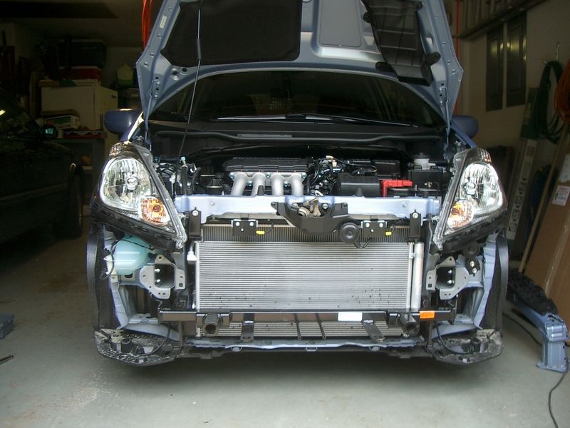

I currently own a 2011 Honda Fit and I'm getting ready to purchase the Roadmaster Baseplates and install it myself. I feel I am reasonably handy with tools and I'm wondering if anybody with experience doing this has some advice. Etrailers posts a pretty good video and to be honest, the most intimidating part looks to be removing and reattaching the front bumer fascia. I suspect (fear) I'm going to break a clip or other cheap plastic part in there and never be able to reattach it straight and solid again :(
The good part is that the kit requires no drilling, uses all existing bolt holes :)

  • I've done 3 BP installs. R&Ring the front bumper/fascia is the only challenging part, and at times it was very challenging. Patience is the key issue. If it don't go, there is a reason, find it rather than force it
    If you are an impatient person, don't even think of doing a BP install !

  • I put a blue-ox baseplate on a '09 Fit. I think I'd agree that removing the fascia was the most difficult part. My highest recommendation would be to use plastic tools as much as possible when contacting a painted surface. The blue-ox instructions for removing the fascia were pretty complete. I don't remember if I broke any pushpins or not, if I did it wasn't very many. I vaguely remember some plastic tabs that were a pain to release without scratching the paint or breaking them off.
  • My son and I installed a roadmaster bracket on my wifes 08 mini.Very detailed step by step insructions came with the bracket,they mentioned every clip,brkt ect. to remove, we got it done under 2 hrs.
    good luck
    Rick

    Roadmaster 521190-1? I looked the instructions up and you're right, good you don't have to drill. Beyond the comments about the push pins, I'd add:
    1. If the fascia pulls away from the body, there may be a row of fasteners that just pull apart and push back together. Nothing has to be actually unfastened or pulled out, simply apart. They're a little scary, but the ones I've done, come apart and go back together very well.
    2. If you need to cut the fascia, don't blindly follow their plan. Wait till you have he baseplate in place, then slip the fascia in place and trim only where you actually need to. I followed that on a Corolla I just did. I cut very little fascia to gain access and the baseplate is much less visible than if I had cut all that Roadmaster suggested.
