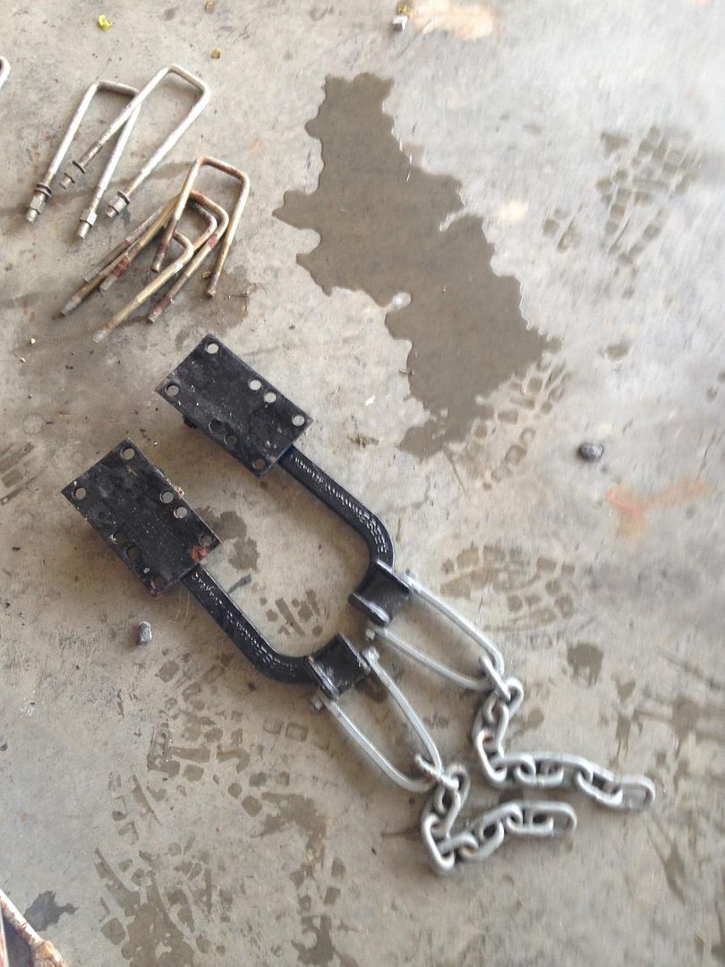

    I went and pulled my cam arms out of my shop. They really are in good condition.
