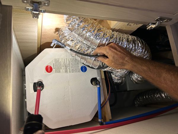

     He was very knowledgeable, began testing…. The element was NOT burnt out, but there was no electricity to it. He checked the control panel, the breaker box… electricity should be there.
     He opened the wall cabinet in the head and began searching—AND THERE WAS THE PROBLEM:
    the electric water heater was not plugged in.
    Ugh!!!    It was inside the wall. I’d have never found it
    Here plugged it in.
     It works.

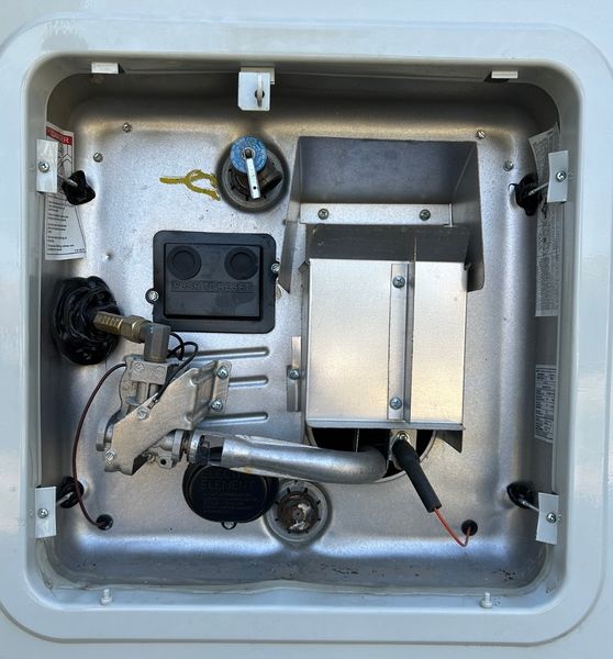

    Here is my update. Please consult this photo
    It is a Suburban, Model L, water heater. I’m told, it has no switch to turn the electric pump off. Just the control panel inside. This box also runs the lp system, which works. The ELECTRIC WATER HEATER never worked. I’m told it is NOT BYPASSED because that water pressure release valve at top will spew water if you open it, which also means the 12 gallon water heater tank full.

      The electric water heater element should be under that big black cover with the 3 screws in it on the bottom left. Turn the electricity completely off, remove the black cover, remove the two wires, and test the element with an ohm meter. You can look up how to test an electric water heater element on the internet. To change it, with the electric still off, drain the water heater, get the proper size socket, unscrew the old one, screw in a new one, replace the wires and cover, and you’ll be good to go. There are videos for this online.
      Do not ever turn on the electric heater element until that water heater tank is full of water. Check it to be sure. If you do turn it on when there is no water in the tank, you can go out and buy another new one and replace it again.

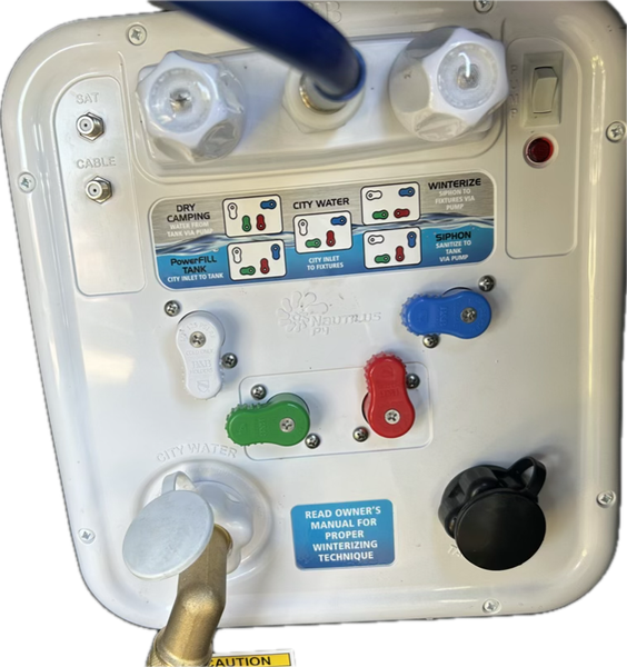

      Does this image of my water control panel help?
      I have it set for city water. It’s NOT on winterization, which I think would bypass the electric water heater.
       So I’m guessing my electric water heater is not bypassed.
      • StirCrazy's avatar
        StirCrazy
        Moderator
        no doesnt help at all, that is for filling not using, it doesnt matter if you have it running from the tank or off city water if the hot water tank is bypassed you won't get any hot water
        Here plugged it in.
         It works.
