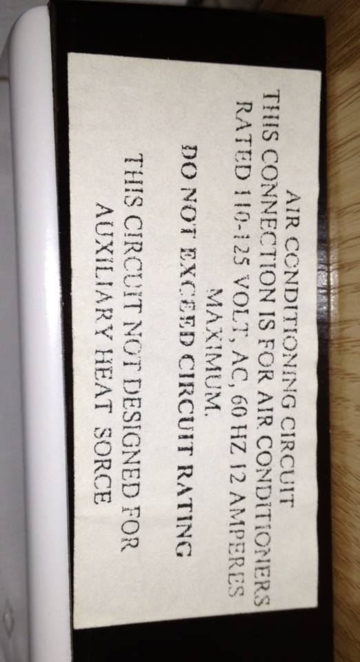

  • Ok, look what I found. This is the junction box inside the closet right next to the vent hole where the schematic says the optional A/C is. Does this mean the wiring is all ready to install the 2nd A/C? I'd rather not remove the caulk and everything to look -- oh, maybe I can remove the bottom part and access the wiring from there...to look? -- Seems to me this is ready for a 2nd unit. That's good news. And now I have the info I need to get the right one as well.
  • Checked it today when it was 75 degrees inside and outside. The air just inside the A/C vent was 43 degrees. So I think the unit is working normally. Something about my rig, maybe the big window....it's very hard to cool off. So...I think a second unit is definitely in order.
    Wondering though, as I mentioned -- if the schematic shows a 2nd a/c option at a certain vent does that mean it's most likely wired for a unit, whether that option was chosen or not?
    And if it's not?
    Thanks for your help...
