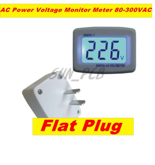

    Overloading.....or weak breaker
    Simple plug in AC Voltage monitor will help you check voltage

    A simple plug in digital voltmeter inside the rig would be a good step to determining the voltage. If the pedestal has both 20A and 30A plugs then most likely the 20A plug voltage will be the same as the 30A plug.
