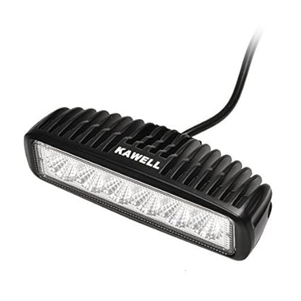

I've been wanting to add backup lights to my TT for several years now.
I've read every single thread here & on other sites, my plan is to mount 4 LED flood lights, 2 on the rear bumper of the TT facing outward & 2 more in front of the TT tires facing outward.
I have verified my 7 pin is hot in reverse & the yellow "7 pin wire" is run back to the junction box where the trailer lights are conected to the umbilical cord.
I want them to come on when in reverse & be switch activated so that they stay on while unhitching/leveling.
I know I need to wire in a relay & I've done a bit of research on it & have a pretty good idea on how to do that, but my main question is which leg of the relay does the switch get wired into The 30 or 86?
The one thing I haven't found online is a "accurate" diagram of how to wire in reverse lights, using the 7 pin for power aswell as using the TT batteries for power along with using a switch "REV, off, on"
One other thing I came across recently was adding a "diode" inline on both the 7 pin wire & on the hot wire from the battery to prevent backfeeding?
