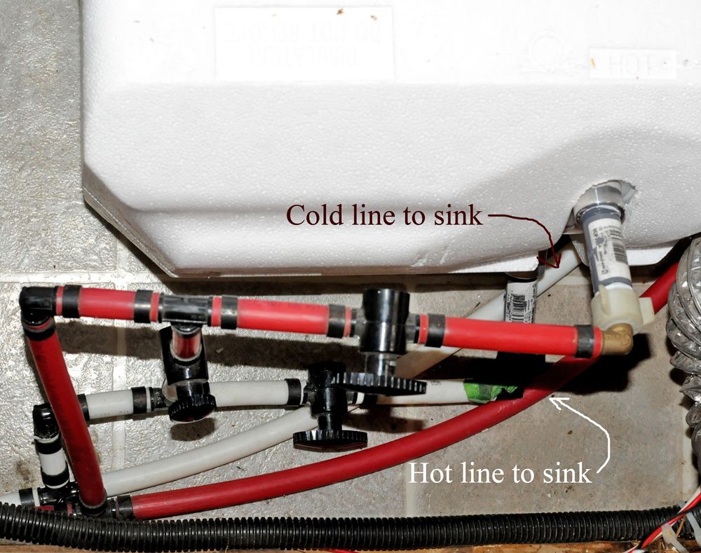

I just installed a new Atwood 6 gallon propane water heater -Atwood Mobile Products 96110 Pilot Ignition Water Heater - 6 Gallon.
The unit appears to operate fine, the pilot stays lit, the burner has a strong blue flame, and the burner shuts down after 10 minutes or so.
I assumed I would have hot water. Actually got warm water for about 10 seconds, then back to cold. I put the temperature control to hot, the burner kicked in immediately and ran for 5-10 minutes, then shut down.
Checked the water at the sink (about 4 feet of pipe from the hot water discharge line from the heater) and same thing - lukewarm for a few seconds, then cold.
What could I have done wrong??
