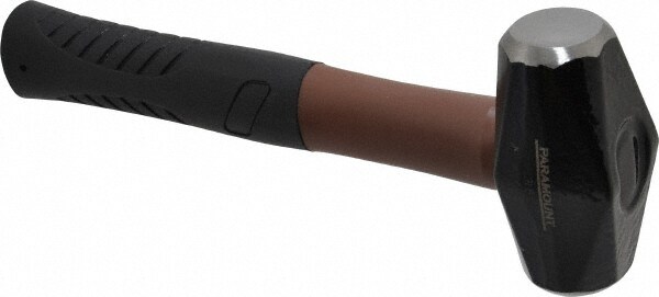

Damdifino's avatar
Damdifino
Apr 18, 2018
Corrosion on cable end!
I've developed corrosion on the male end of the cable that plugs into the truck. Is there a product or technique to remove it? It's causing an intermittent outage in my brake controller. (Pardon me if the link doesn't work.)
https://www.dropbox.com/s/h34ngzvamkh4b06/corrosion.jpg?dl=0
23 Replies
About Technical Issues
Having RV issues? Connect with others who have been in your shoes.24,412 PostsLatest Activity: Sep 09, 2026
