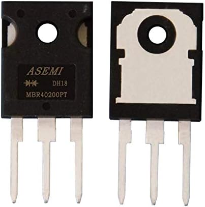

5 pack of 40A Schottky diodes
HERE for $9
Those actually are a "dual diode" package, contains two diodes that you can parallel if you like..
