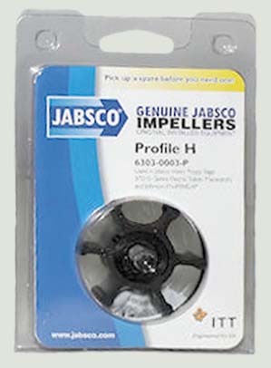

  • I rebuild mine every other year.
    The impeller always has a broken vane or two and the others are cracked.
    Get the kit, take it apart, clean it and put it back together.
  • You can purchase the rebuild kit....2 flat fiber gaskets, the impeller, o-ring and lube for $19.50
    BUT just the gaskets......haven't seen any 'just gaskets'
    http://www.absak.com/catalog/product_info.php/products_id/822
