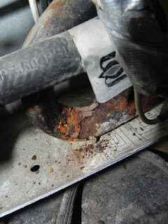

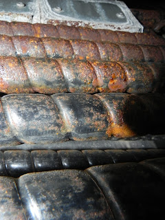

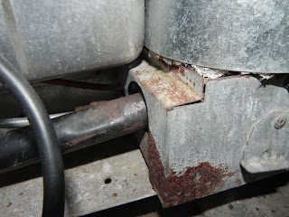

While outside looking in from the outside I noticed more rust than I would like to see on the cooling unit. I later returned with the camera to take some photos of it.

What are the thoughts of this cooling unit.
And taking it all together, what now?
overall pic:
Close up of bottom corner of the cooling unit tubing:
tank:
