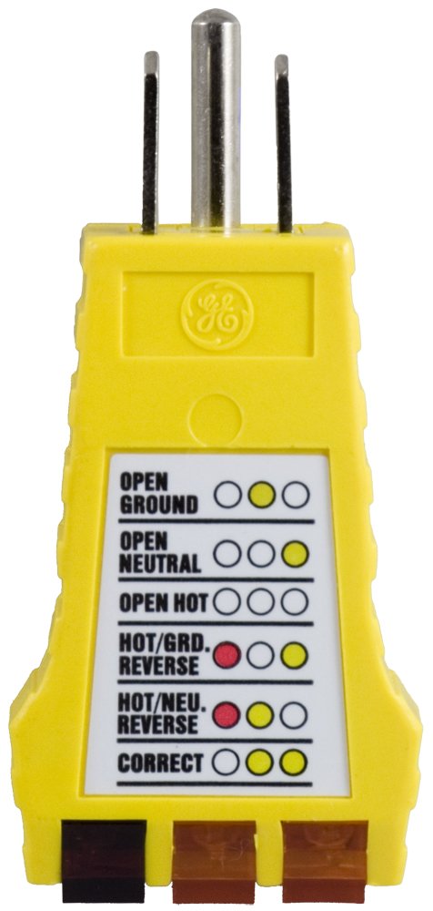

A quick way of checking outlets is with an outlet tester like the one shown below:
