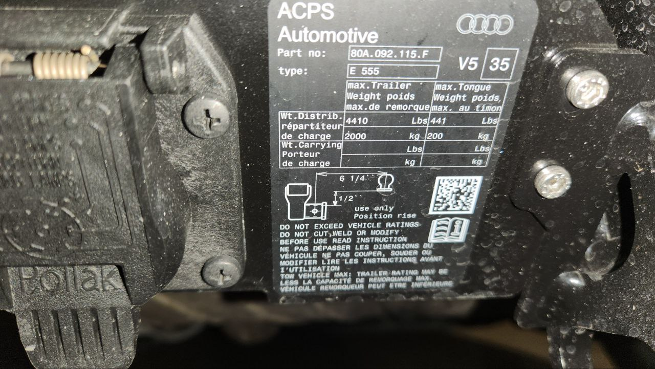

Thank you for the tip! And if I place a heavy object in the back of the trailer to reduce the tongue weight to an acceptable level, is that a good idea or still a bad one?
I have a gasoline engine, not a hybrid, 2.0T with 252 hp and 370Nm of torque in stock.
Thanks for the tip on the lithium battery. My battery is actually on its last legs, so I have more than one reason to consider replacing it with a lithium one.
I don't have the user manual at hand, but I have a photo of the sticker on the hitch itself. It seems that the maximum height is 6 1/4. However, I'm not sure what they meant by 1/2. The diagram is confusing to me. Could you help clarify?
If I'm reading the table correctly, they require a wdh and the base of the ball within a half inch of the top of the receiver opening.
It's odd that they don't show any capacity for weight carrying (the way you are currently set up). Probably need to go down to the audi dealer and get them to confirm. Ask for it in writing or they may just tell you it's fine without confirming to make you go away.
Aaah, now I understand. The maximum lifting height here is 1/2 inch. What am I supposed to do now? Can I drive with the trailer lowered down?
As far as I understand, with a single-axle trailer, I can tow it with the tongue tilted forward. I just need to remember about the tongue weight and the clearance.
What do you mean by capacity for weight? Sorry, I didn't get it. It shows the tongue weight and the max trailer weight
