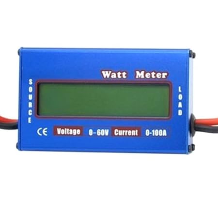

  • get something like this Power Amp/Watt meter
    put it inline with the battery measure how much power you use
    per day AKA 24hrs and per night
    to be truly effective for long camping periods
    the solar has to twice what you use between sundown and sunrise
    it has to replace what you used at night..while recharging the batteries and powering what power you use during the day
    however.. IF you merely want to keep from killing the batteries aka extend your stay and then recharge them while the TT is in storage
    you can use a smaller solar system
    yes figuring out Both how much you use and what you want from the solar system.
    most people do NOT need "the full blown ..double power"
    matching your nightly use.. is enough for most people
