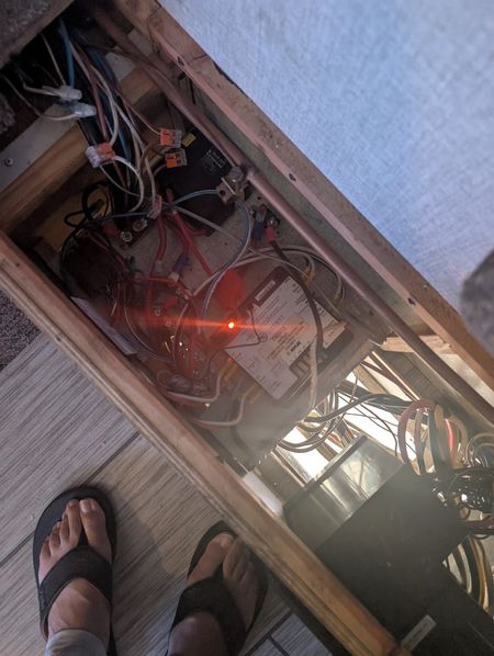

All the ground bars looked good. Everything was tight.
Pulled the 15A fuse again to inspect it and it looked fine so I put it back.
Checked the blue/white cable that's called out in the manual and tightened the wire nut for it. One of those two things did the trick.

Probably the wire nut. Wire nuts are a poor choice in mobile applications. Might want to substitute crimp connectors that won't vibrate loose.
