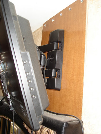

I do the wall tapping and usually have good luck finding them that way.
Holding up anything of any weight however I will add a back board first and then mount the unit to the board... Never any pull through problems doing it this way...
Something like these google images...
