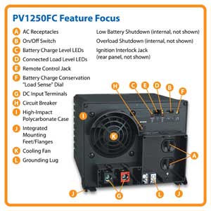

    I highly recommend a Tripplite PV1250FC which is a industrial MSW inverter built like a tank which is the inverter I used in my conversion.
    Right now you can get it for about $235 through Amazon (ship and sold by Amazon) HERE. That is not all that more money than the cheapo HF inverter at $169...
    1250W continuous output with an honest 1875W surge for up to ONE HR and 2500W surge for TEN SECONDS!!! No other inverter out there can match what this Tripplite offers.
    "Harness your vehicle's battery to efficiently power office equipment on the road or power tools at a work site. Continuously supplies up to 1250 watts of 120V AC power to 2 AC outlets from any 12V battery or automotive DC source. Frequency control locks AC output at 60Hz for operating stability of motor loads. Includes a set of high current DC input terminals for simple permanent installation. Highly reliable large transformer design specializes in powering motors and other inductive loads with high-current startup needs. PowerVerter Plus Inverters acmodate "peak surge" demands by delivering more output power than their continuous rating. Compare the "Continuous" and "Peak Surge" wattage ratings and you'll find PowerVerter Plus Inverters supply up to double their output to easily handle equipment start up and motor cycling requirements. A DoubleBoost feature provides up to 200% of the continuous output for up to 10 seconds providing the extra power needed to cold start heavy-duty tools and equipment. An OverPower feature delivers up to 150% of the continuous output for up to 1 hour. Primary InformationPower Device Type : Power converter Power Device / Form Factor : External Voltage Provided : AC 120 V +/- 5% Voltage Required : 12 V Power Provided : 1.25 kW Input Connector(s) : 2 Output Connector(s) : 2 x power NEMA 5-15 Enclosure Color : Black Width : 8.7 Inch Depth : 9 Inch Height : 7 Inch UNSPSC CodeUNSPSC Code : 39121006 "
    It is big and heavy weighing in at 24 lbs..
    Also is about 90%+ efficient, the HF inverter is something like only 82%-87% efficient meaning you will get more run time from your batteries..
    And even better the PV1250 also has a power save feature called "load sense" which allows the inverter to detect if there is a AC load or not ans the inverter will turn on/off for the AC load demand! Saves a lot of battery capacity!
    I would highly recommend that you use very heavy gauge wire, I used 1/0 on mine, fused at 200A and the fuse needs located within 18" of the battery.. You NEED to locate the inverter CLOSE as possible to the batteries, mine is only three feet from the batteries for a total of 6ft of 1/0 wire..
    I would recommend getting Extra flexible 1/0 wire, you will need to order this since Home Depot and Lowes only stocks building wire which is NOT real flexible. Welding wire can be used which is extra flexible but not cheap for this size..
    There are some mail order outfits which do sell at good pricing..
    1/0 Entertainment/stage lighting cable for $2.35 HERE which is a deal compared to 1/0 welding cable or even building wire..
    Then you run normal Romex wire from the inverter to the fridge for the 120V..
    You NEED to consider some GOOD batteries, I used a pair of 6V GC batteries wired in series to get 12V for my setup, gives me about 20hr-24hrs without needing to recharge and since we run light on other battery draws it works great for us.
