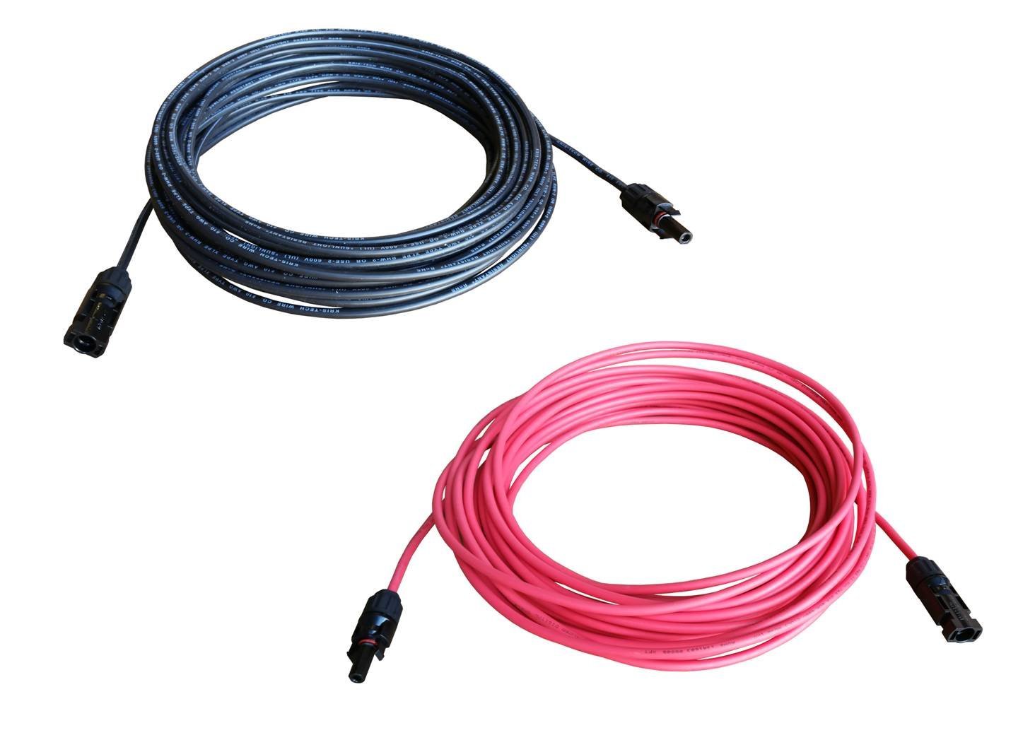

1. 30 ft of 8AWG wire with C4 connectors. Is this an adequate length? And is the gauge large enough? Or can I go with a smaller gauge and save some money? Link Here

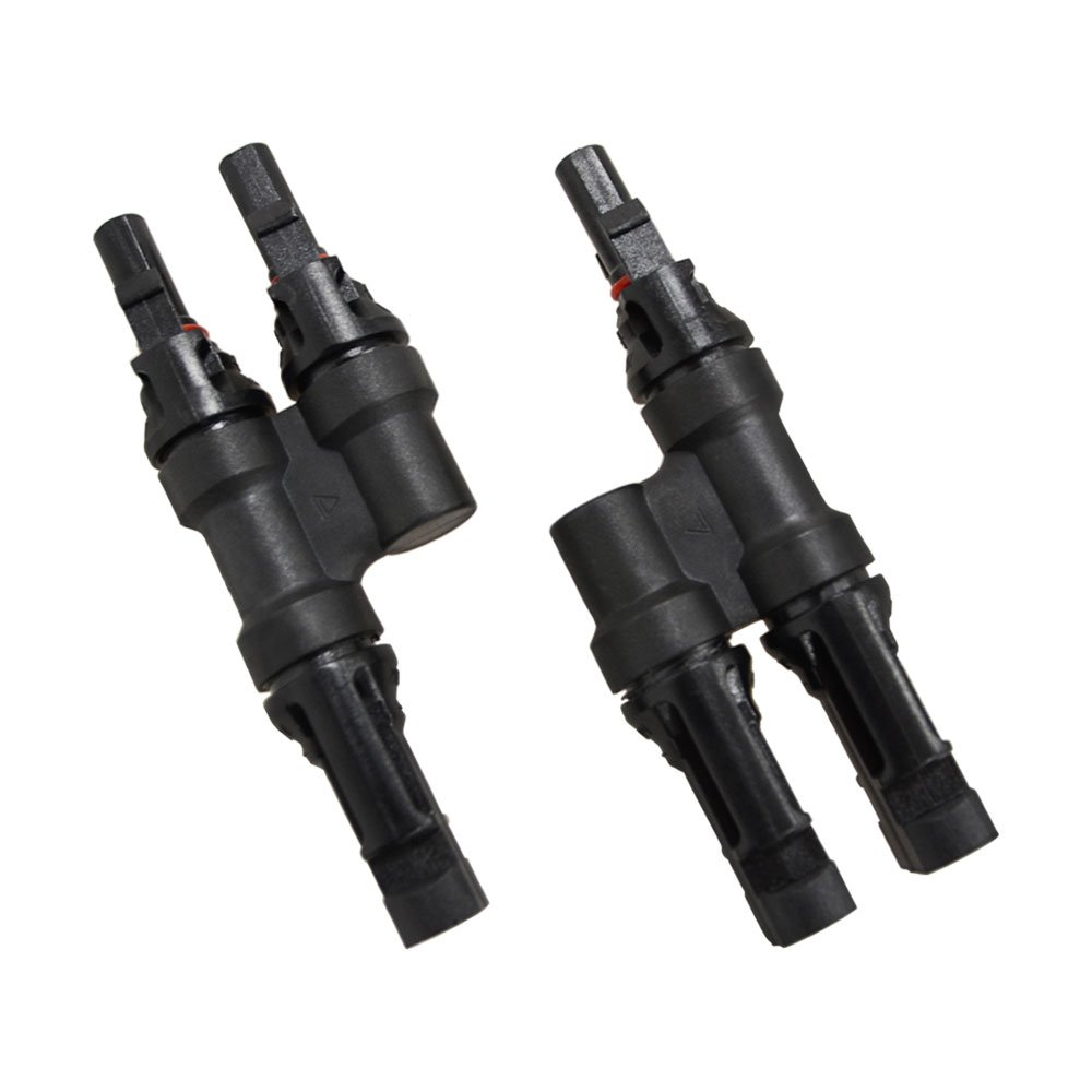

2. Renogy CNCT-MC4Y Branch Connectors Solar MC4 Connectors Y connector in Pair MMF+FFM Link here

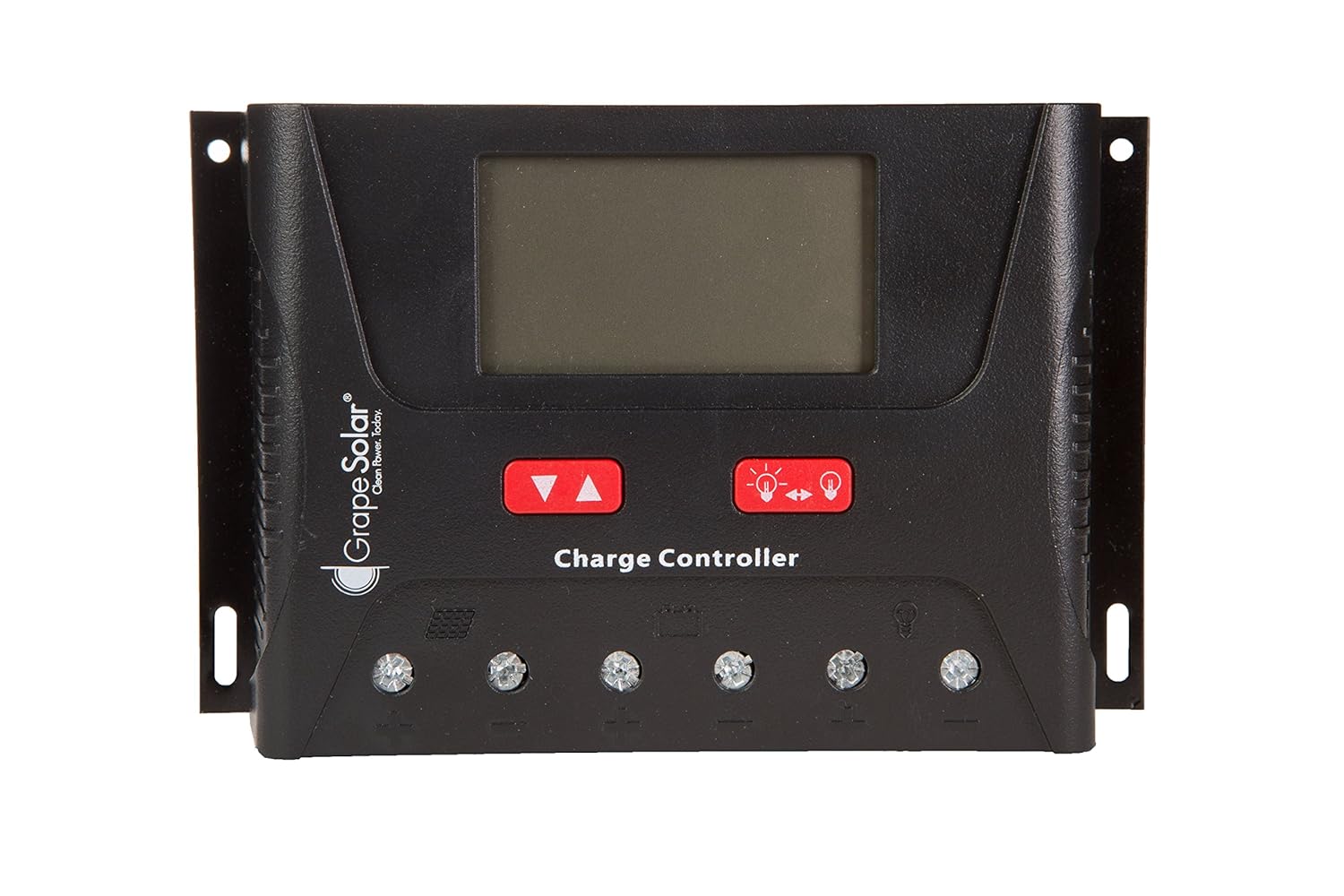

3. Grape Solar GS-PWM-40BT 40 Amp PWM Solar Charge Controller with Remote Monitoring (I intend to us my Apple iPad’s Bluetooth to access the remote monitoring). I plan to mount the controller in the pass through at the front of the travel trailer. Link here

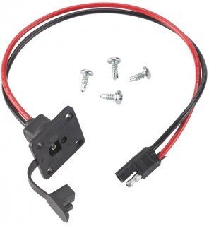

4. Battery Minder EZ Connector. This will be the plug in to the side of the trailer and will connect/disconnect panel wires from controller. Wire size for this is 12AWG, but I will be only using these wires for very short distance (less than 1 foot).
Link here
