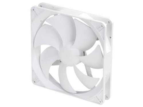

I replaced the OEM range hood fan in our coach with this SilverStone High Performance Fan. It comes with a speed control, but I found it to be so quiet on full speed that I didn't use it. In fact, it's so quiet that I added an LED indicator next to the power switch to remind us it's turned on. It draws easily as well as the noisy OEM fan.
Guess it hasn't melted with the heat?
That was my main concern when considering this ...
No problem so far, after almost two years in this coach. I suppose the grease filter provides some heat protection as well. I did the same mod in our previous coach, and that one is still working fine as far as I know. I did use the speed control on the previous install, but quickly discovered that it wasn't needed.
