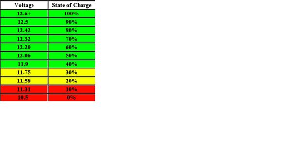

    Here's a chart of battery voltages. If you notice it doesn't take much for a battery to be dead. That's why it's important to get voltage numbers for us to be able to help you troubleshoot.
