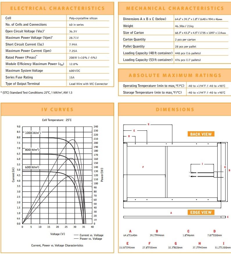

I recently removed a solar system from my home I just sold to re-install on my new home. Since the newer home is going to be smaller I thought about keeping two of the panels to install on the 5er. They are Sharp ND-208U1F.
What I am trying to understand is what size/type controller to go with. I guess I should preface I am trying to keep the cost down. I figured since I already have the panels I would try solar on my RV. I don't necessarily "boondock", but when we take the TH out it is usually where there is no shore power. So I would like to not use the generator to charge my batteries.
If my two panels produce 416 watts then Ohm's law says that is 35 amps with a 12 volt system. Correct? Therefore I need to go with a 40+ amp controller?
