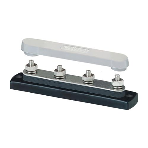

    I use BLUE SEA BATTERY SWITCHES, BUS BARS, FUSE BLOCKS etc components with all my battery projects where ring terminals are used for the connections...
    Everything is sealed against the weather and battery vent gases keeping all of the connections in great shape... I do the same with my FRAME GROUNDs as well...
