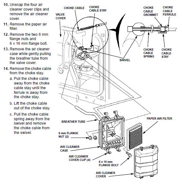

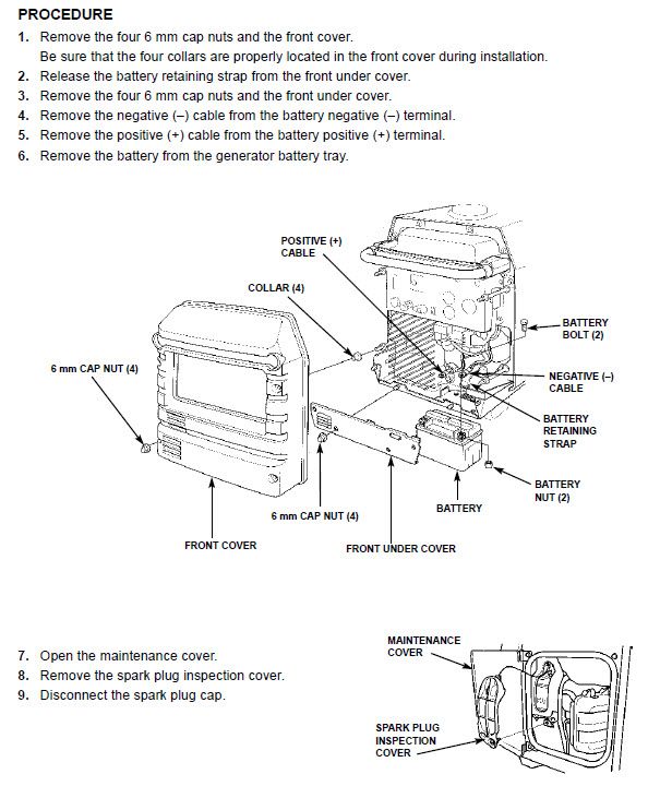

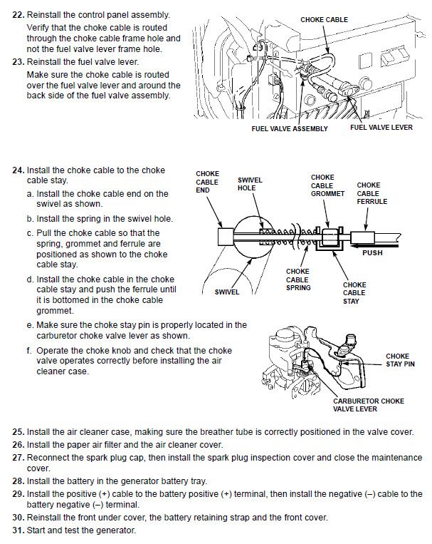

    You got it; here is the complete procedure to R&R (remove and replace) the inverter:
    -Robert@Honda
    Caveat: I work for Honda, but the preceding is my opinion alone.

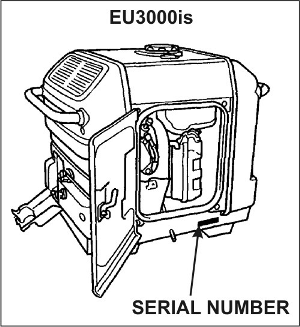

    There was a Service Bulletin issued by Honda for this issue back in March, 2005.
    1. Open the side door and get the serial number:
    2. If your serial number is in the range of EZGF-1023302 ~ 1120322, then it could benefit from an updated inverter module, which has been updated to address the issue with breaker tripping when a load is removed.

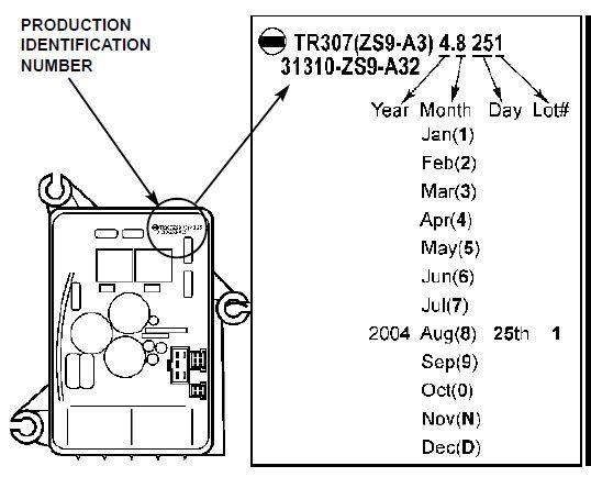

    You might look around and if you find a used EU3000i, perhaps one that is being parted out, or is damaged, check the serial number on the unit and get one outside the effected range. Or, look at the date code on the inverter itself; you want one mfg AFTER 8/25/2004. Here's an image to help:
    -Robert@Honda
