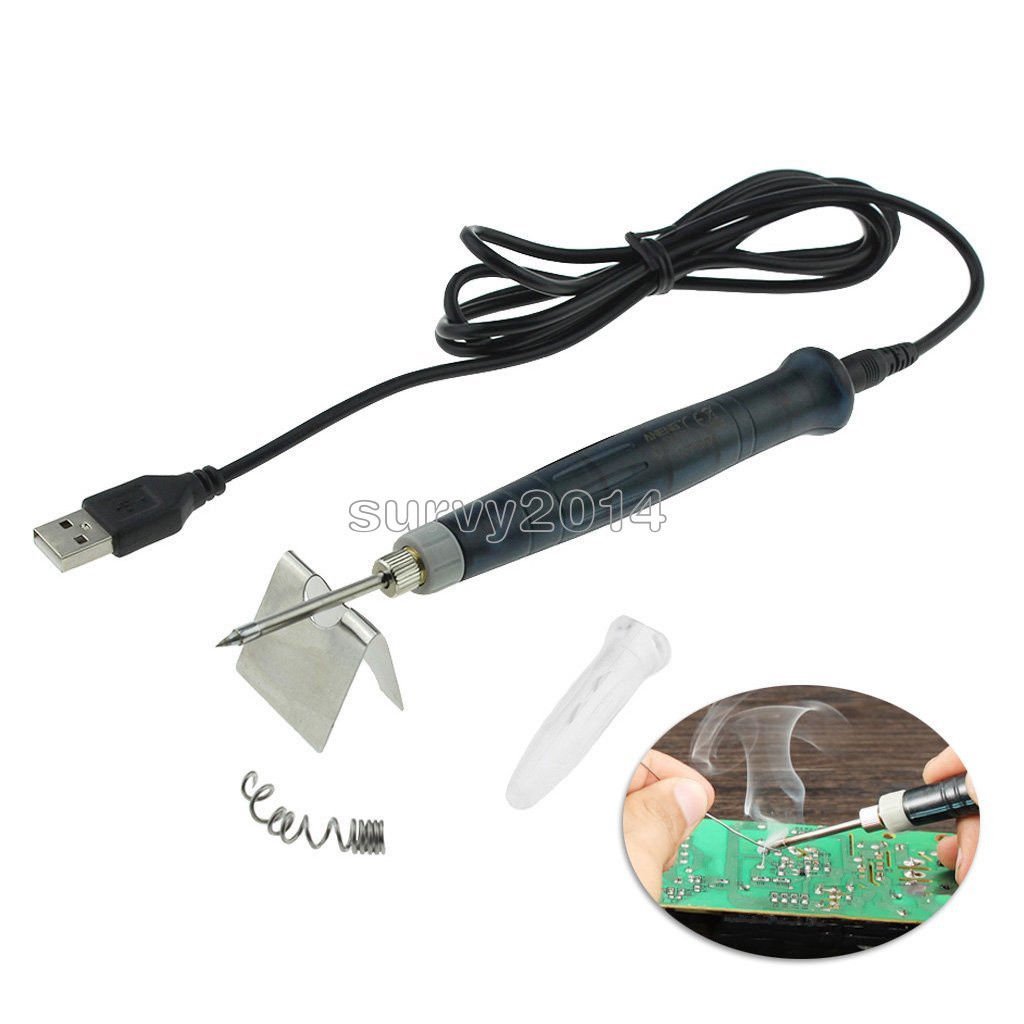

  • There are a number of 8W 5V mini solder pens: Amazon. I have no idea if any would fit your application.
